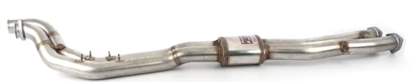

    I'd install a resonator in the section 2 (the biggest one that will fit - I think Borla makes a great option) similar to how Super Sprint has a resonator after the H pipe (or x pipe in your case).
    Click image for larger version  Name:	Screen Shot 2026-08-17 at 12.04.36 PM.png Views:	0 Size:	185.4 KB ID:	364118
            did you actually do that and it got quieter or is this an idea you say I should try? What's that image? It does not look like the magnaflow for the e46 m3 that I have... are you just showing the kind of resonator?
              That screenshot is of the twin-tube resonated Supersprint Section 2. I’m currently running this setup on my car. My recommendation is based on my actual experience with it tangentially but primarily to show you where you can add another resonator downstream.
              The SS Section 2 can serve as a good point of reference for where you could add a resonator to the Section 2 of your Magnaflow system.
              Since your Section 1 already has a fairly beefy resonator, your Section 2 is really the missing piece - it currently has no resonators, just the X-pipe. Adding a resonator there should reduce the overall sound output enough to make a meaningful difference.
              From my perspective, the “box” on your Section 1 is probably doing more to muffle the exhaust than two individual AR20s would. That’s why I’d be inclined to add a resonator to Section 2 rather than trying to add more muffling to Section 1.

              📸 @alpinem3
                You didn’t happen to put a section 2 resonator in your maganflow system before changing it out right? This is all just a hypothesis? I agree with you on adding a resonator to section 2… I have the magnaflow system currently and helmholtz resonators were too narrow band to cover all the drone so I am thinking about adding magnaflows resonated x pipe in place of the unresonated one… as long as there is room.
