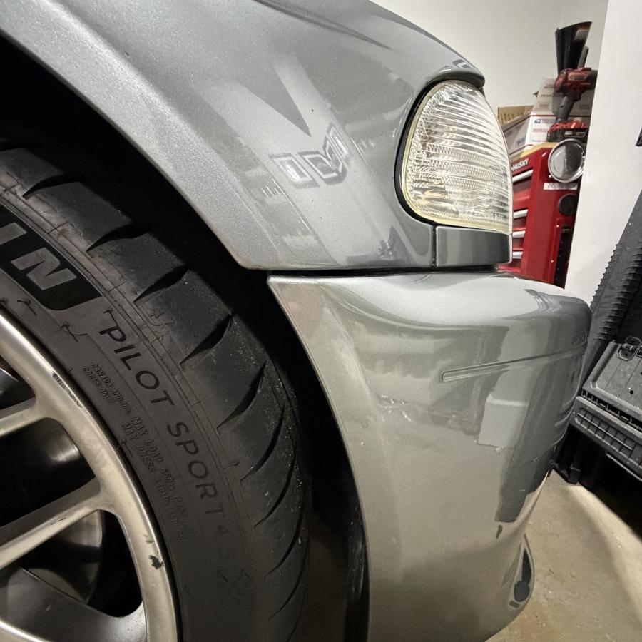

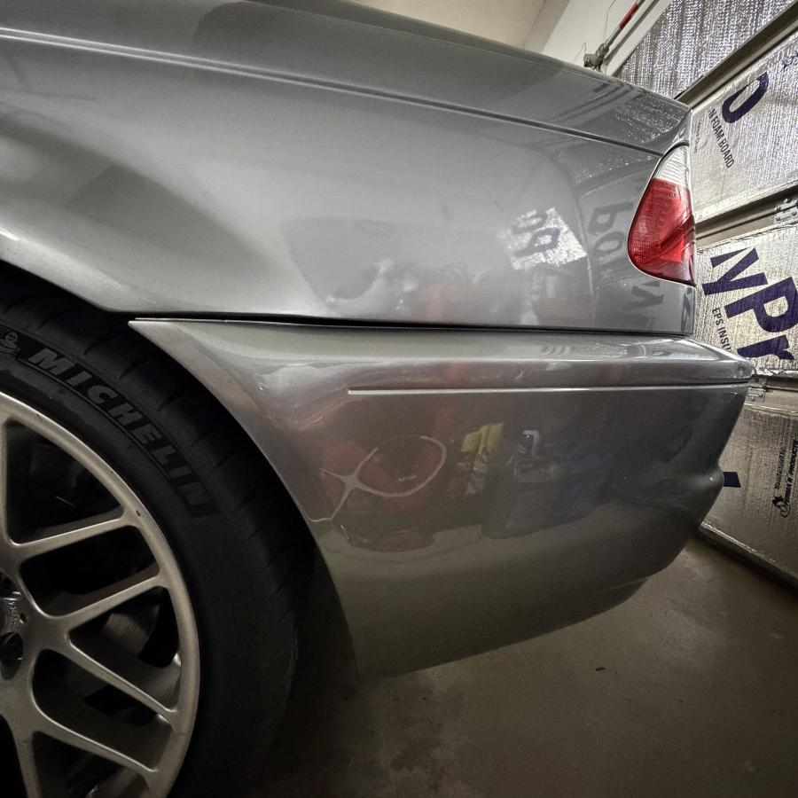

    Had a body shop paint and install a brand new euro bumper + repaint existing rear bumper. The original bumpers were not in great shape (purchased that way) and did not fit great. I got the car back from a well regarded shop and at first it looked fine but the more angles I looked at it I noticed the body lines are not exactly lining up. I know it’s an old car and there are tolerances and expectations. Is it unreasonable to bring it back to request a better fit?

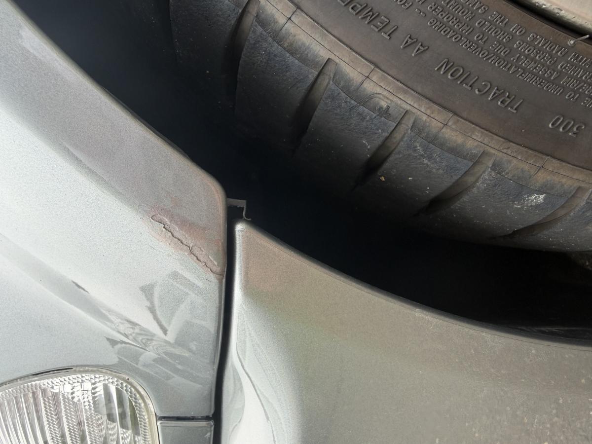

    I ordered a genuine euro M3 front bumper through dealer part# 51117894989 for Kevlar support bar It came in and I got it painted then tried to install it only to see these 4 tabs on the backside interfering with the Kevlar bumper support. After some searching, those 4 tabs originally came in the aluminum carrier bumper to
    I wonder if they left the tabs on, I put a euro bumper on a few years ago and had to dremel the tabs off otherwise it would have had similar fitment.
    Whatever is going on, thats sitting too far foward to a significant degree.
    May not be their fault if the tabs are the issue, but at least you can tell them and they can get it right if you do not want to mess with it yourself.
      This is pretty common, although yours does look extreme.

        They simply do not fit great. There is really nothing to pull the sides of the front bumper back to match the wheel arch better other than the plastic rivet that also holds the wheel well liner in place. you can play with the plastic side mount to help, but never going to get it to stay exactly where you want it. The rear bumper should have a little clip that helps hold it tighter to the quarter panel.

            horrible fit
              Take those 4 tabs off and it will fit fine.
                THIS! A month ago, I decided to dive into fixing the non-perfect passenger side fitment and I discovered the thread explaining the manufacturing issue for the kevlar bumper covers and the tabs not being cut off. I cut off the tabs and also marked the locations of the ball pins (on the carrier) and sockets (on the bumper cover) to make it easier to confirm that all four are fully snapped in. Now both sides are tucked in properly with the passenger side no longer sitting slightly too far forward.
