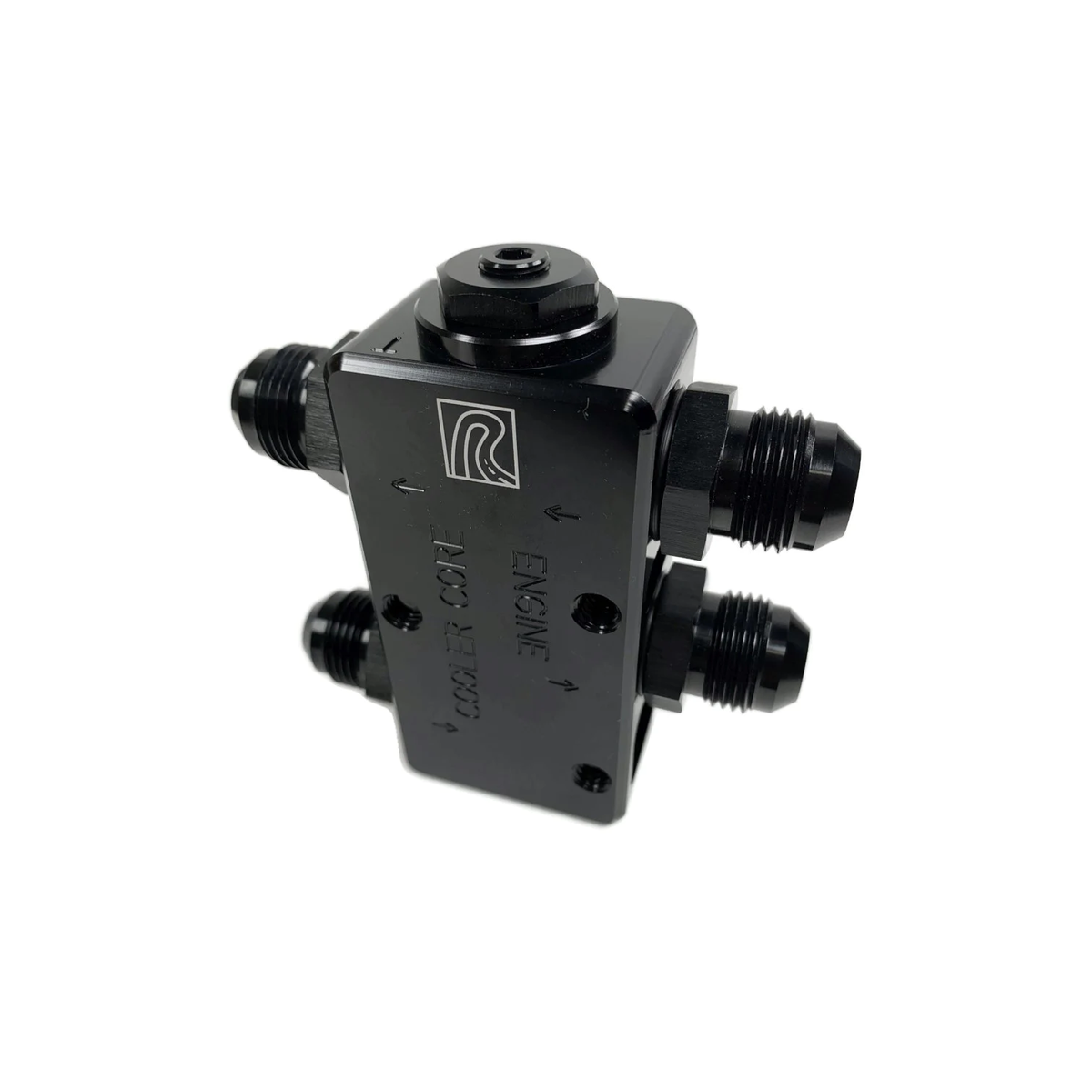

    There are many in-line oil thermostats available.
    One example:
    Adding an oil cooler to your track car can be one of the best mods you can do, but it is good to regulate the temperature to now allow overcooling of...

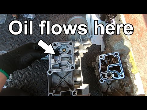

            I was not sure on the oil flow path of the OFH and found this video not too long ago explaining it and the difference between M54 and S54 OFH

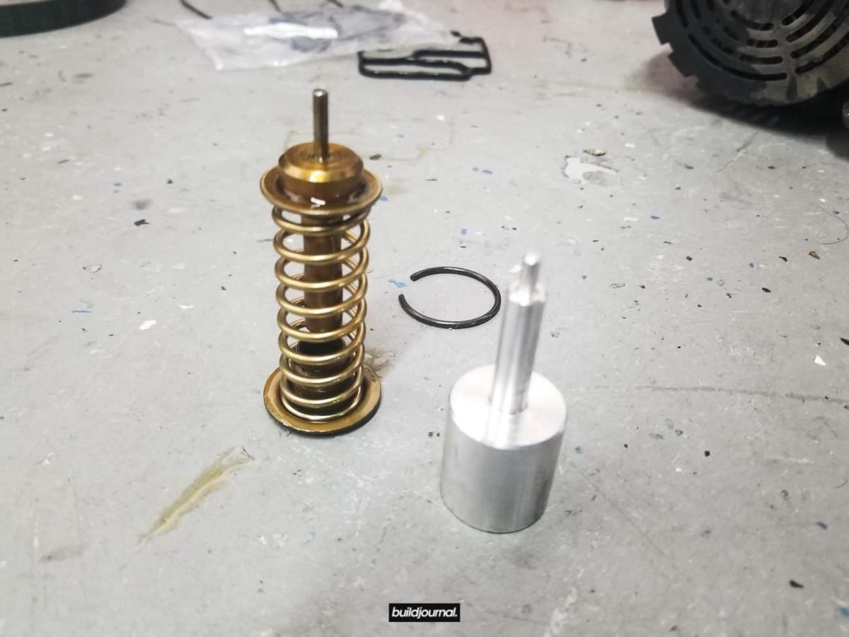

            I don't know if you can buy the thermostat separately. I only see a delete kit.
              Thank you for the video. Most of the video i had seen must have been for the E36 M4 of non M E46 OFH's.

                This is the thermostat I use on my track car: https://ebay.io/m/MvpteT
                If you have an OFH with the bypass, probably can ask around and see if any track guys have the guts laying around. I think its just a spring.
                  The non-S54 OFH's just have a check valve rather than any thermostatic regulation.
                  This is the VAC bypass kit below with oilstat on the left
