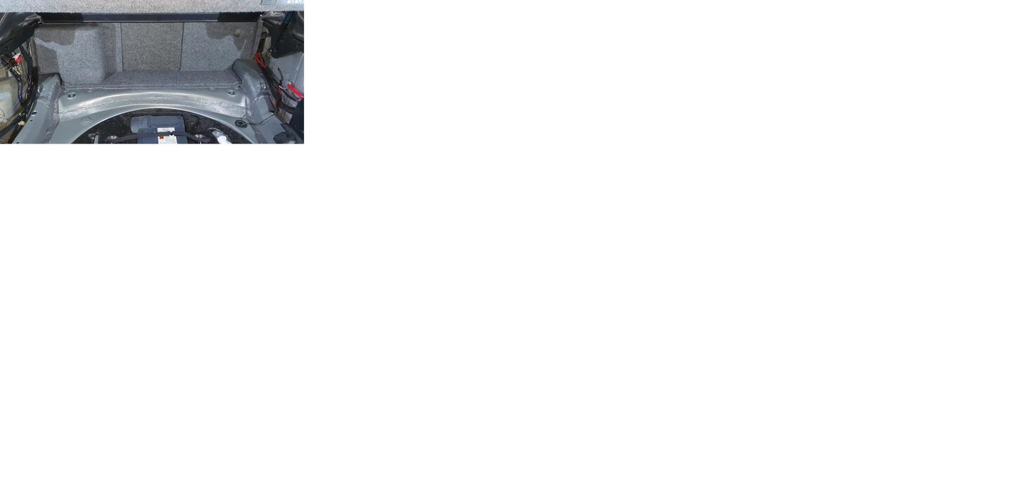

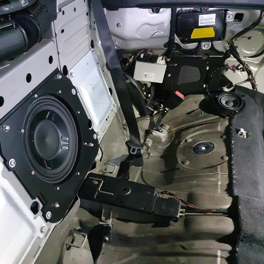

              I fitted a 10" Rocford Fosgate 200W sub driver in the front of the ski pass by making up a bracket using the ski pass as a template and closing up the boot-end of the ski pass with carpeted wood.
              The cavity behind your rear seats makes a decent ported cabinet and you lose no boot space! Sounds great (driven bty a 200w Clarion amp). Also did the Bavsound upgrade as the HK tweeters sound terrible (they have plastic domes)

                You don't happen to have any templates left over from this, do you? I bought my vert with a system already installed, I love the audio quality. Only downside is the box for the single 10" sub makes my trunk unusable beyond a small duffle bag.
                I'd love to make something like this and get some usable space back. What does the passenger side look like with the seats installed?
