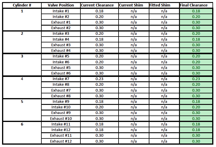

              Yes, it was nice - I was able to speak to the guy that did the job for about 20 minutes; very experienced. Crank and Motor were in outstanding condition. Any sign of copper in the oil and they replace rod bearing in their personal and race vehicles. No break in required, warm oil to correct temp and send it. Motul 8100 Oil. Ceratec is good stuff, many people use it, they are agnostic; fine with, fine without - just change the oil yearly on a low mile car. I was given the used bearings, they had a few 5 gallon water bottles filled with used bearings . Valve train fully checked, zero adjustment required, 100% in spec; I was given the record sheet, no shims changed / added. That was the majority of it, as I recall.
                Attached is the Valve inspection measurement record Click image for larger version
