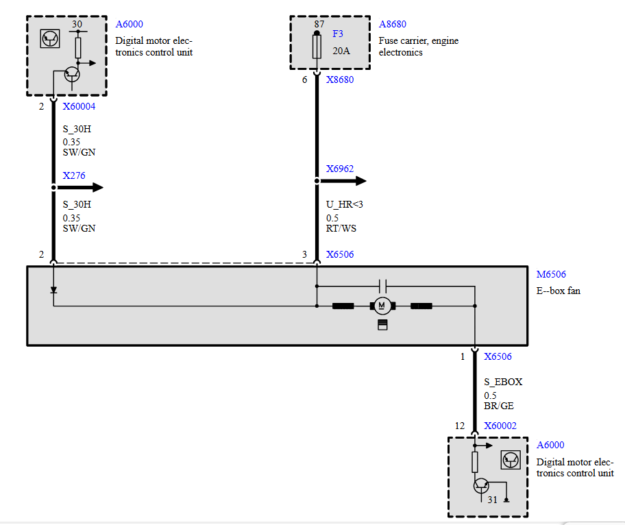

            Originally posted by blazenXLT View Post
            For testing, I pulled fuse #4 from the small black box that's inside the electronics box, I'm pretty sure that's the one that is the output for that fan..
            Based on the wiring diag, the DME itself capable of driving the small efan alone even with 20A fuse pulled out. So it's high chance that the noise is from the running e-box fan.

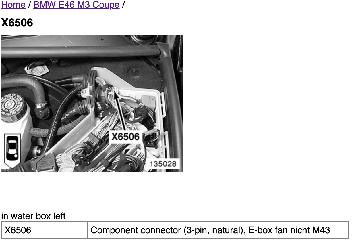

                The connector for the DME fan is clipped to the inside of the DME box (on the side closest to the windshield IIRC). Think it's worth disconnecting it while you hear the noise to make sure that's the failing component.
                Edit: This one

                  A bad fan cannot run itself, so I would blame the DME or an external wire ( neg side of the fan) that shorted to gnd to cause current flowing thru the fan 2 wires.
                  To do: pull the 24pin connector off the DME (or cut black/green wire off pin12 of 24pin connector) and fan should stop. if not check if that black/green wire has 12v or 0v; if it's 0v then the wire is shorted to gnd.
                    Edit: This one

                    When I pull this, the sound continues...
