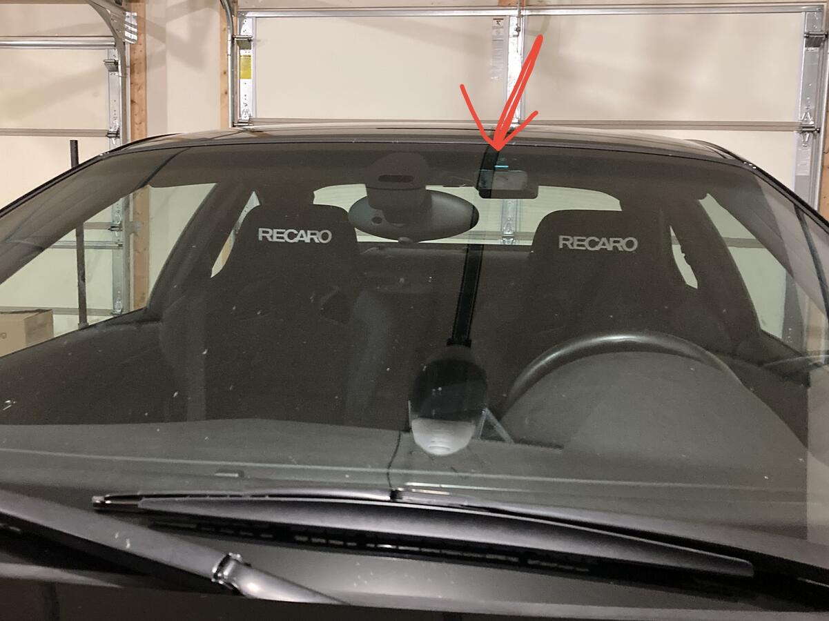

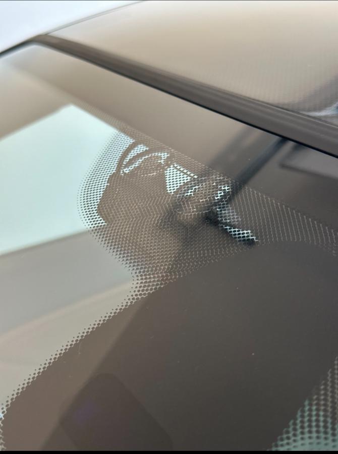

              For anyone running the 703 Infrared windshield, mounting a radar detector in line with the dot matrix cutout can be challenging. I can confirm that placing the detector anywhere else on the windshield renders it useless.
              I picked up a V1 Gen 2 and managed to squeeze it between the rearview mirror and the headliner to clear the cutout. It sits at an angle—not ideal—but it works perfectly.
              I couldn’t find much info on radar detectors for infrared/climate comfort windshields, so hopefully, this helps someone looking for a viable solution.
              I’ve always used a Uniden R7, but it’s too bulky for this setup. The V1 Gen 2, being about half the thickness, fits and does the job well.​
