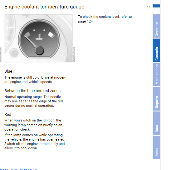

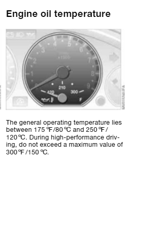

              Has any one here opened their owners manual? Im just going to leave these here...

              Im not saying that its isnt a good thing to be concerned about "rising" oil/water temps, but rising indication on the gauges are not necessarily abnormal. Some cars gauges creep up, some do not. I do wonder if the gauges had this characteristic when the cars were new off the lot, however I would wonder why BMW would include these provisions within the manual if they didnt.

                  I know I know, telling you to open your manual is as about as useful as telling you to turning it off and then back on again, but ive seen this sort of thread posted literally dozens of times, only for everyone to suggest to each other to replace every little thing in the car, only to have no improvable result afterwards. These cars do run hot, especially in hot weather, and nearly always when driven hard. I dont mind being the guy to tell you that perhaps what youre experiencing in 100+ degree weather might not be abnormal, just to save you from the wild-goose chase. But in the end you are just caring for your M, so I can respect that. Hope you resolve the issue, will be following.
