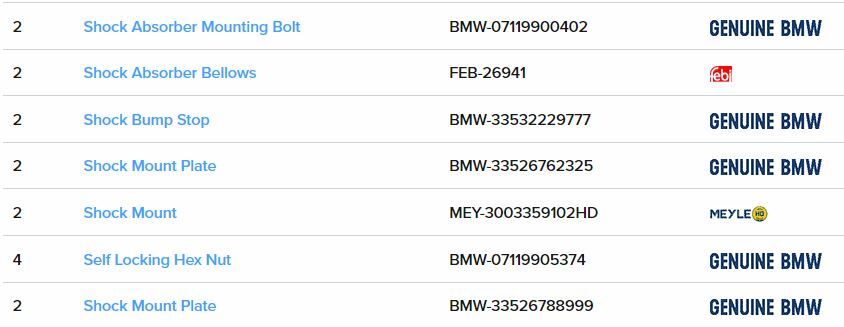

    Click image for larger version Name:	Rear Shock.JPG Views:	0 Size:	35.0 KB ID:	41381
    Unless you think your bolts are in bad shape, you can probably buy the RSM Meyle HD kit (includes reinforcement plates I believe) they have and get everything you need. I would recommend ordering new bump stops, and wish I had ordered them when I did my suspension. Even the latest E46 has 14-yr old foam at this point, so they're all shot. I put in Koni's with their Meyle kit and had no issues with install, the rears are especially easy on these cars. The only place you can upgrade is a different RSM such as the Rogue mounts which allow for shock removal without interior disassembly, or a monoball mount which some folks have given positive reviews of.

    So if replacing OE suspension with the Koni Sport (Yellow), would all the OE hardware still be applicable?
    Anything from this (rear shock) FCP Euro list not necessary any more, or some thing you would upgrade/do differently?
