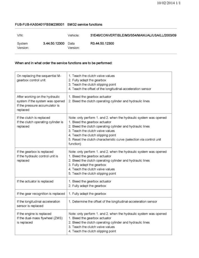

Figured I'd share this for the ones who are troubleshooting SMG. Its a redacted oem doc but there's a decent diagnosis info.

06-27-2020, 09:39 AM
That's exactly what I used when I changed my engine. I would really like to know how you can do an engine or trans swap without opening the system.
