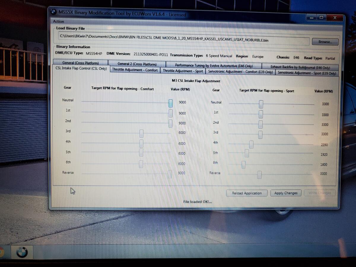

    Could someone post up their flap opening RPMs, I just wired mine up and am experimenting with it..
    This is what I have set so far, I don't like it so much because I like to hear the box in 2nd gear high RPM and in 3rd mid RPM range. I always have to hit about 4k to really hear the box and that has always been the case and probably quite normal. Right now the flap won't open in 2nd at all unless in Sport Mode which is kind of a bummer for lack of noise.
    I have a pedal commander so the Sport button isn't really used that often. Off hand I was thinking that I might roughly match Comfort and Sport mode opening RPMs.
    Also, I CAN feel a difference, at low RPM in first and second at around neighborhood street speeds it is more responsive and feels a bit more "torquey". Also, it does quite the car down at reasonable speeds, but we all knew that. Took a long time to wire it to my satisfaction!

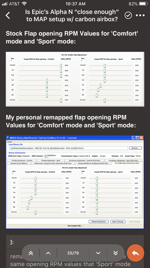

    I used the settings below that somebody posted from the old forum. Basically just copies the stock sport settings to comfort. For sport mode it has the flap opening at much lower RPMs across all gears. I like it because who doesn’t want to hear induction noises more often!?
