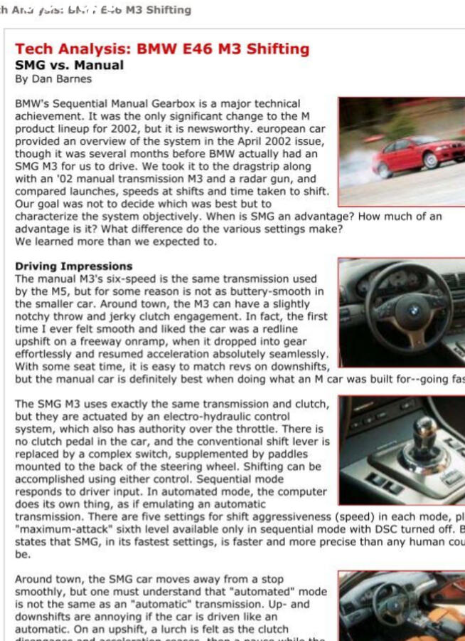

      It makes me feel slightly better that European Car magazine notes the notchy feel even when new
