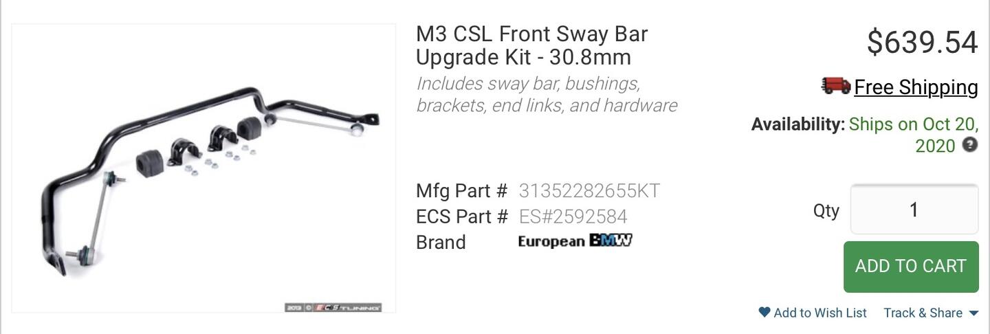

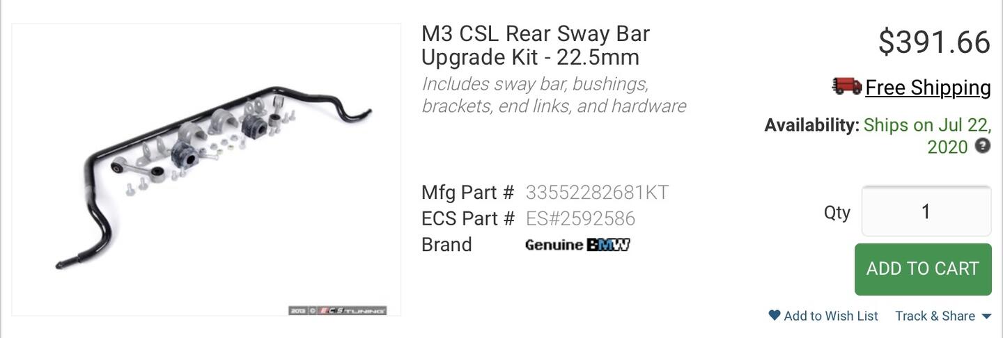

            From ECS’s website:

            For the matter of discussing cost, the total CSL sway bar tally is just a smidge over ten Benji’s (that’s Benjamin’s, or $100 dollar bills if the slang doesn’t register). $1,000 dollars is not exactly chump change. I’ll first start by giving my impression on adding CSL bars to my ‘05 M with stock bushes, then with Powerflex bushes, and then my final conclusion.
