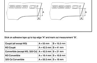

    Pet peeve seeing this wrong out on the roadways

    Great info, Is there one for the CSL trunk lid?
      I am trying to install a new badge on my M3 as the previous owner removed it so I am looking for a template. It looks like there are 2 or 3 different recommendations out there, which one is correct?
      1. The one shared on this thread

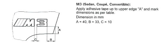

      2. Shared on m3cutters: https://forums.m3cutters.co.uk/threa...on-boot.74998/

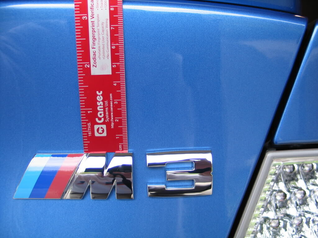

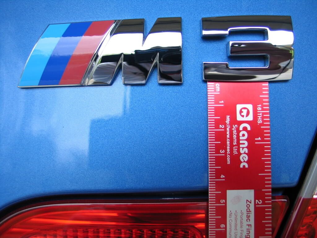

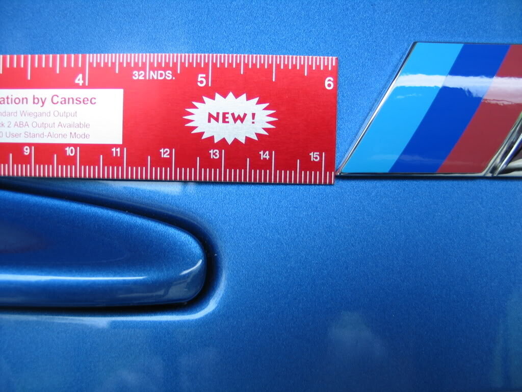

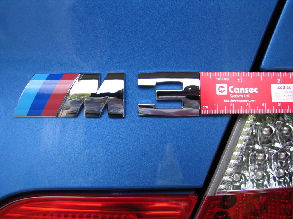

        Reviving from the old forum. Brand new from the factory:
ID:	123146Click image for larger version
          Awesome, love the power of forums✊, Thank you. So it looks like the YouTube link is pretty spot on 👍

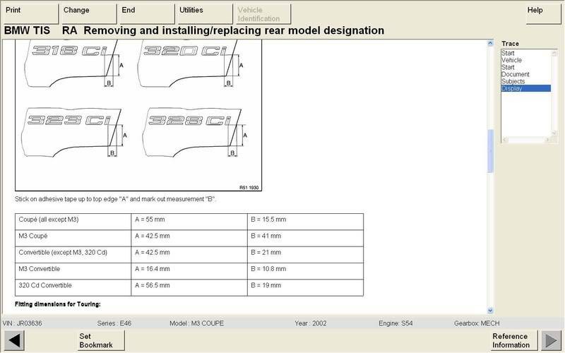

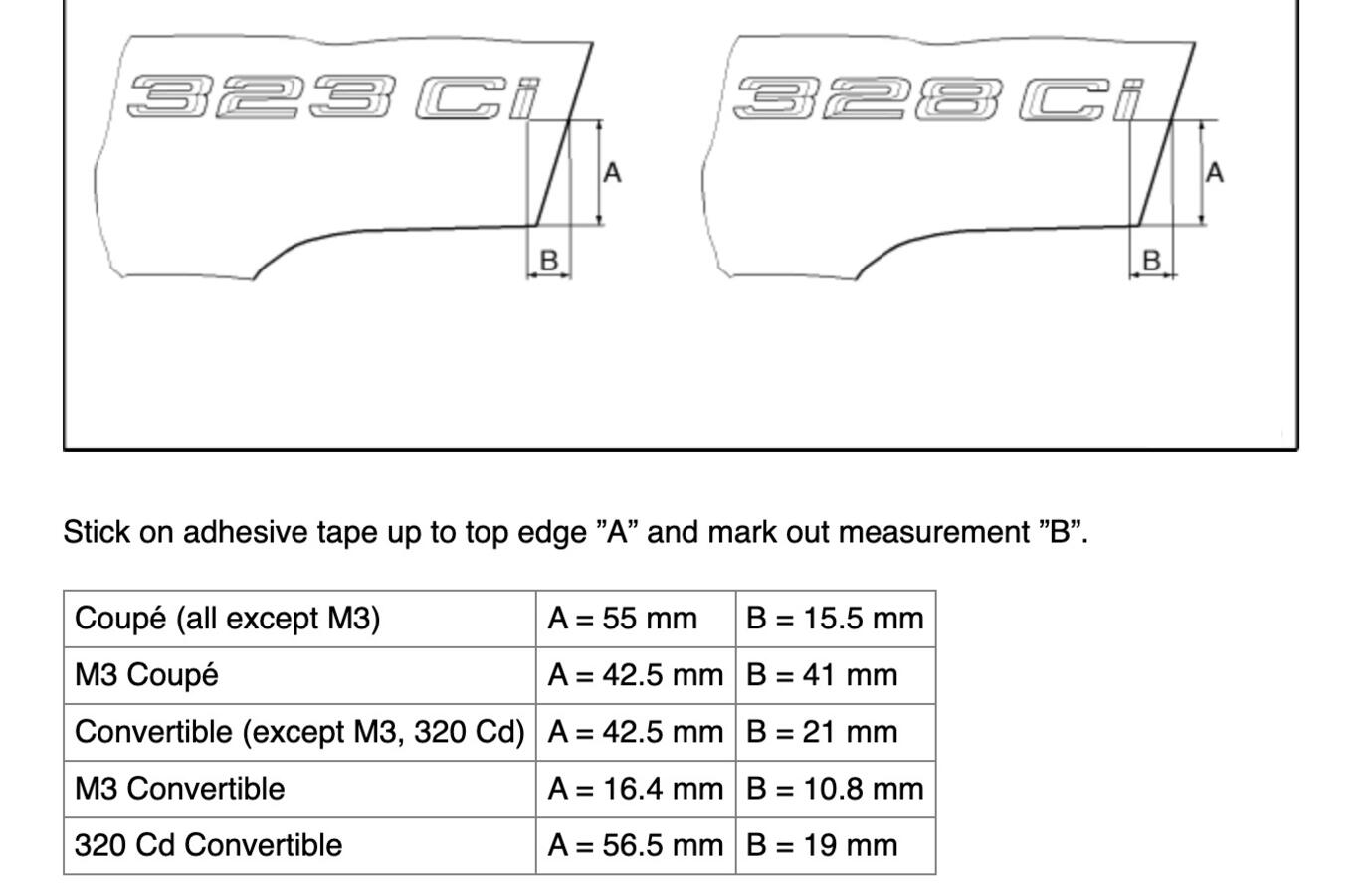

            3. Shared on YouTube: https://www.youtube.com/watch?v=AuM13vkiaBQ
            Looking for this? Vert is lower than the coupe -
              Click image for larger version Name:	emblem.jpg Views:	0 Size:	74.3 KB ID:	123153
              But see this chart is not accurate f you look at the factory badge placement on Estoril 's boot.
                I see now and also that someone posted this chart in the first post . It looks like the B value is incorrect for the coupe and much closer to 19mm or 21mm. The vert might still be correct as it is placed here on the bootlid:
