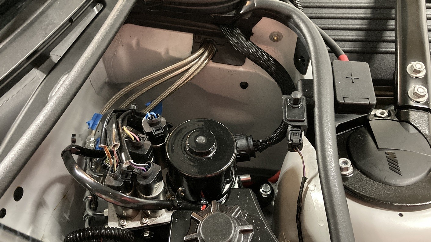

  • eacmen
    replied
    Pic of mine in the drug bin. I simply zip tied the lines together and tucked behind valve covers on passenger side. Driver's side seems like I tied the lines to something sturdy. I'll take a look tomorrow. I have no issues and have been relocated for quite a while now. They lines have never moved.
    Click image for larger version  Name:	IMG_2517.jpg Views:	0 Size:	368.3 KB ID:	168417

  • oceansize
    replied
    Tackling this project now. This PDF is good resource for how to remove the pump. But not necessarily for the full relocation.
    The only real unknowns for me at this point is where/how to route and secure the lines to the drug bin. The steering column is dangerously close to the factory pump location. I ended up using zip ties into one of the factory rubber mounts for the smg pump.
    Haven’t secured the hydraulic lines yet but I assume securing them somewhere in the intake plenum is probably a good idea.
    The drug bin has a rubber insert for LHD cars. I plan to cut a hole in that rubber insert and route the lines through it. Don’t want the hydraulic lines rubbing straight on the sheet metal.
    Pic of mine in the drug bin. I simply zip tied the lines together and tucked behind valve covers on passenger side. Driver's side seems like I tied the lines to something sturdy. I'll take a look tomorrow. I have no issues and have been relocated for quite a while now. The lines have never moved.
