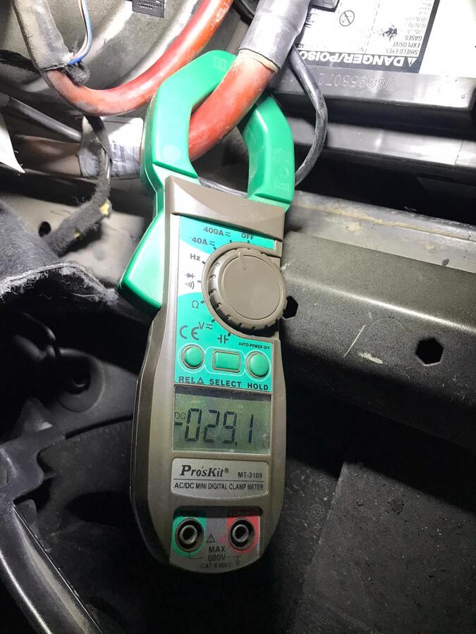

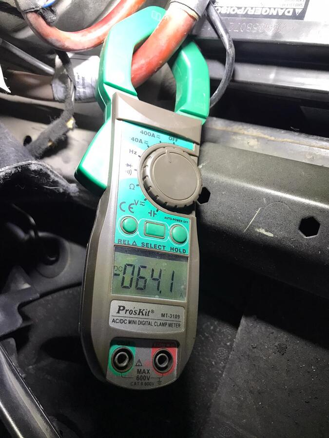

                          Shonky sapote Thank you for your insight and I will pass it on to the techs.....I'll keep you guys updated. Mean time here is the read out with and without load.
                          Without load

                          With Load

                          No load => 29A
                          With load => 64A
                          what does this mean? Are these the current flow out (discharge) or into the batt (charging)? I say it is the discharge current because with load, the voltage at the batt must be lower and not higher and so the discharge is higher.
                          OP, remind us what is the load? Is it the AC turned on load? If without load and the batt was discharged at 29A then your battery soon would be empty. Do you have battery discharged issue?

                              So previously I said the 29 and 64A was the discharge current, but after review your posts again I didn't see you mentioned about dead battery issue. So I thought again -- are they charging or discharging currents?
                              Looking at this pic. It has 2 red cables to the battery. The bigger one (being measured) connected to the starter and alternator, and the smaller one connected to the rest of the car. So I was wrong in saying those currents were discharging from the battery. With more load, there was more current flowing out on the smaller cable from the battery post, and so the alternator increased more current (69A ) to the battery via the larger cable. This design is a little odd and will waste more energy as the alternator high current has to flow twice the length of the car: from alternator to battery and then from battery to the load which is mostly at the front. But I think it had to be done this way in order for the BMW engineers to add the BST (battery safety terminal? to cut off the current in an accident).
                              For our cars, the alternator is spec at 120A max current. If your car suck out the other running car 100A in addition of your own 120A, then whatever the load on your car needs about 220A which is very large and should be easily be narrowed down to that component. Ask your mechanics to use the same current-meter and check on the thick wires coming to the fuse boxes. Start at those high current fuses first.
