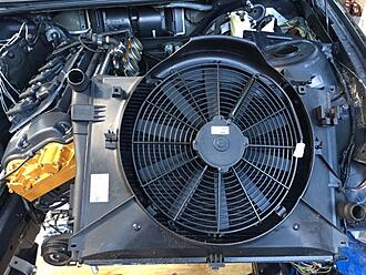

    I got my brackets/fan/controller mocked up while I'm away from the rest of the car for the next few days. Does this look correct to those who have used the N15 brackets?
    Correct me if I'm wrong, but I assume most people put the fan towards the passenger side of the radiator, as to not interfere with the water pump. I think this means that the aux fan controller bracket would need to go towards the driver's side of the radiator. If this is the case, I'm worried that in the way that I currently have it oriented, the wire aux fan plug would not reach the other side of the aux fan wiring loom.
    Also, the DIY I was following (https://thebuildjournal.com/diy/n15-...fan-mount-diy/) seems to have a slightly different aux fan controller, with different wire colors. The DIY I followed did black->brown, red->blue. Since my controller has brown and grey wires, I did black->brown, red->grey. Does anyone have any info on if this was correct? Or possibly why there may be a difference in appearance/colors between cars?
    That looks correct. There were different wiring colors between model years. Thanks for your purchase!

  • repoman89
    replied
    Brown wires in a BMW are always ground, so you should be all set.
