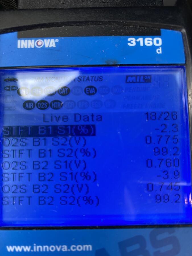

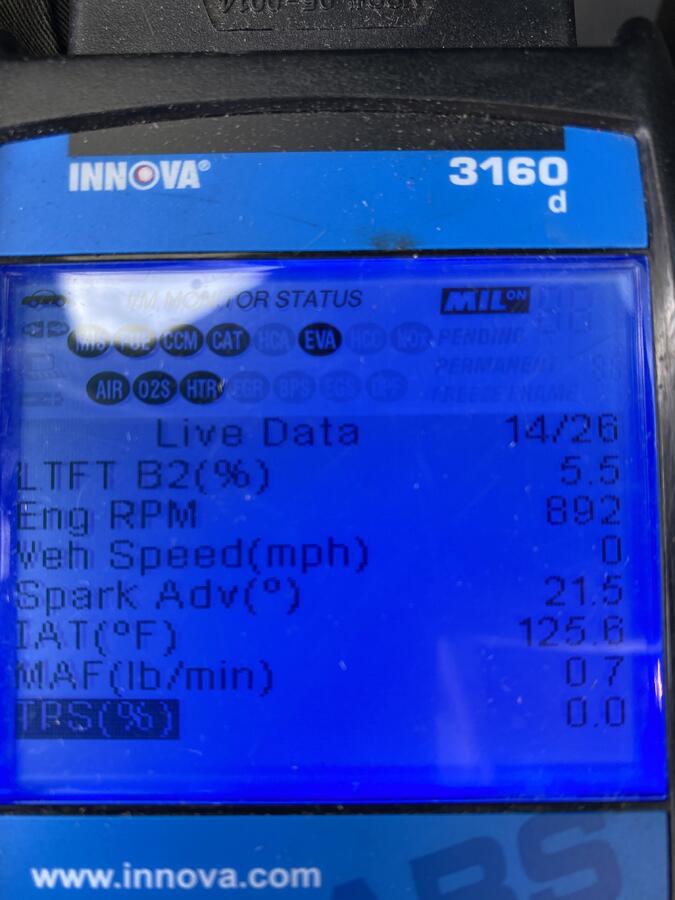

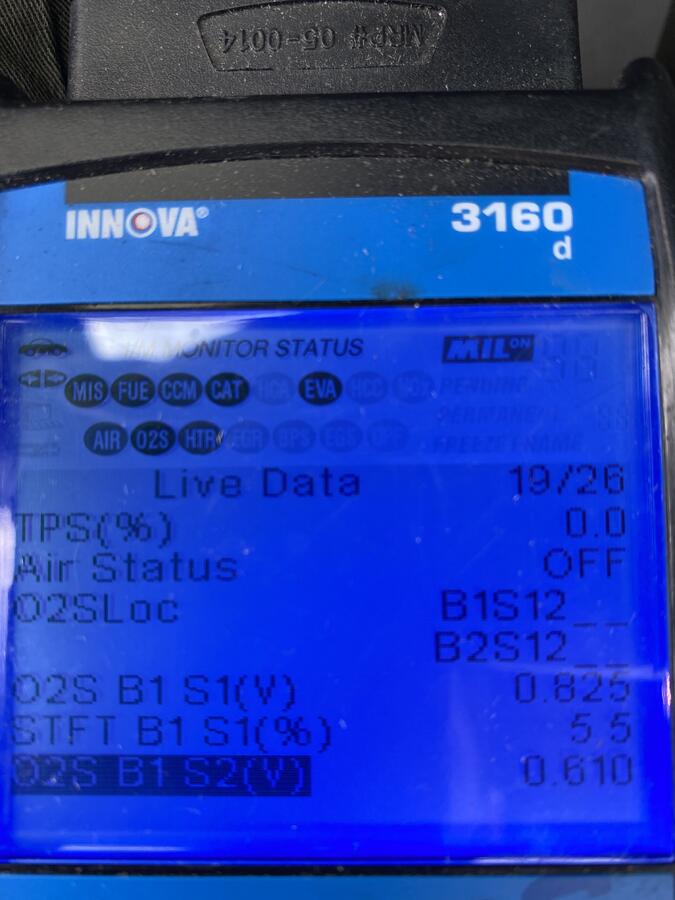

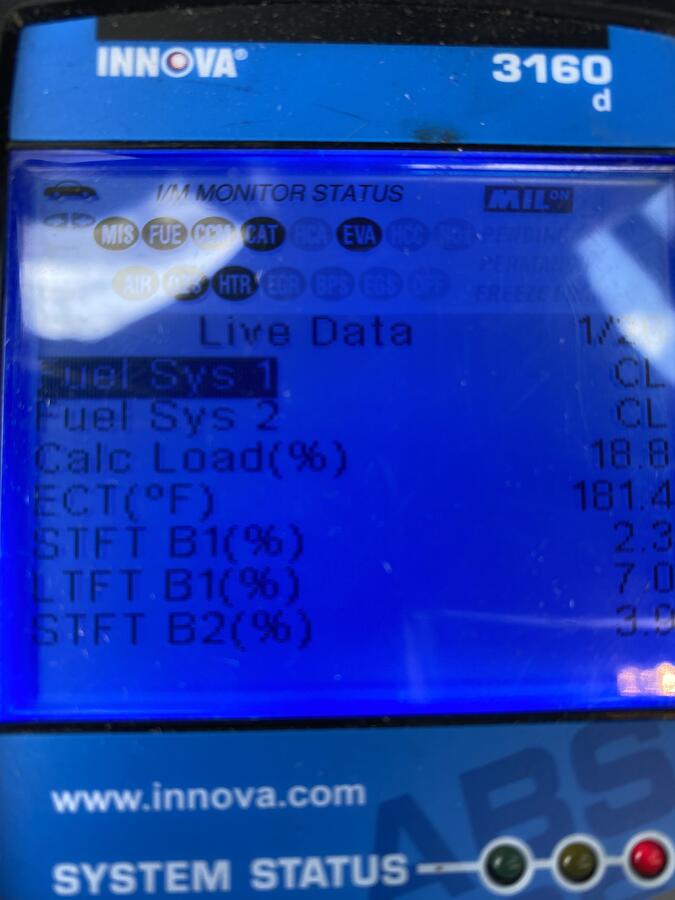

                    Was there an update here? Mine just cropped up today with p0430 and p0420. Trying to figure out why post o2 sensors are 99.2 percent and stuck there

                          youre more than likely either going to turn down the sensitivity or replace your cat. I had to replace the cats on my s54 mcoupe years ago. There could be a small chance your post cat o2 sensor has gotten lazy. You can check with a obd2 scanner to see what the o2 sensor voltage is. I'm not sure on the procedure but there is a way to tell if your o2 sensor is the issue.
                          For me though nothing I tried worked until i replaced the cat. At the time it wasnt possible to tune down the sensitivity. Keep in mind, as of monday the BAR in california will begin checking for modified ecu code. So using KAIV might not work.
