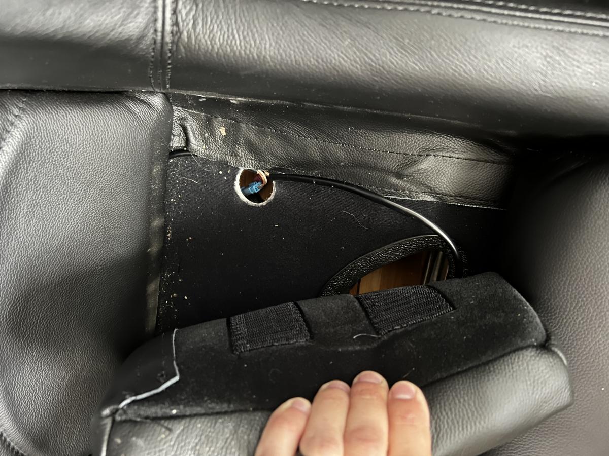

    Originally posted by R1pilot View Post
    I honestly had no idea there are different models of PP. Here are a couple of pictures of my seats:
    Click image for larger version  Name:	i-nFw86GL-X3.jpg Views:	47 Size:	110.0 KB ID:	186881
    Click image for larger version  Name:	i-Dhrs2gV-X3.jpg Views:	44 Size:	128.5 KB ID:	186882
    Take a close up photo of the lap belt hole. The tag may also contain the information you need.

  • R1pilot
    replied
    Which Pole Positions do you have? I will be listing for sale driver side BK mounts that will work for the regular width PP, but not the PP ABE (I found this out the hard way).

  • elbert
    replied
    Do you have the B-K part number for the brackets?
    I have some Pole Position and a set of manual sliders that I want to put together. Right now I am using fixed Recaro brackets.
