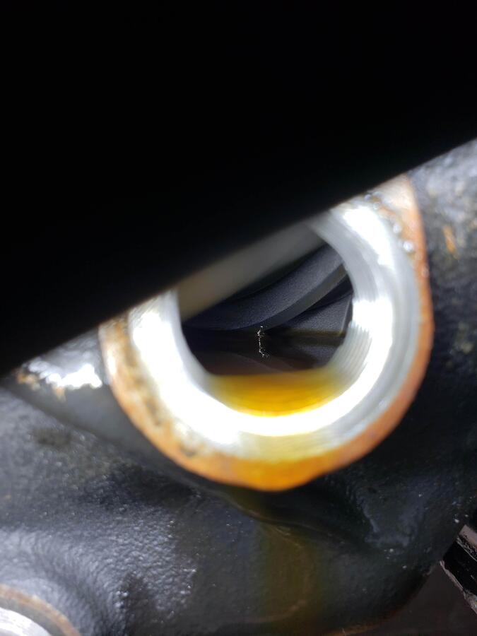

                  So I ordered Quick Jacks from the Costco sale a couple weeks ago and am waiting on them to come in before tackling this seal. I figured I still have 300ml of fluid leftover from the original job so I'd top it off. Raised the whole car up on blocks on level ground and oil started pouring out...not like popping an oil plug but more than a drip or stream...som steady flow.

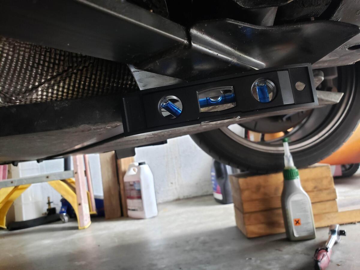

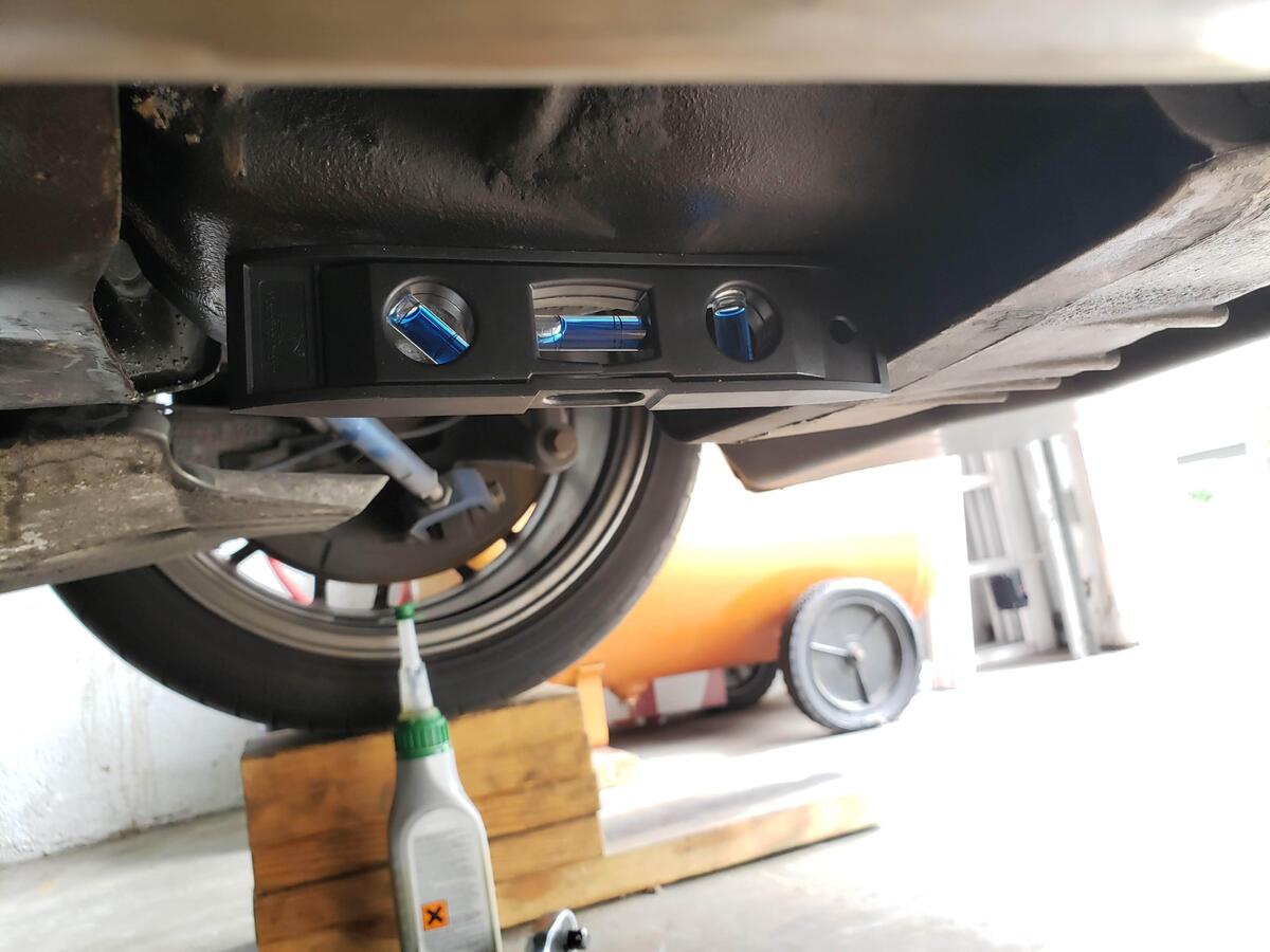

                  So I thought okay, "level surface" must not account for rake lol. So I lifted the front from the center point enough that the side jack pads were equally off the ground. Then I put a level on the diff body and the diff is not level (I guess the body is angled). So I put the level on the rear chassis brace and it's level. Is this the level I want?
                  I popped the plug off again and it was still trickling for a second or two. Once a slow drip I capped it.
                  So...I have no idea what's going on. Did my diff have too much oil in it and that's also what caused the front seal to die so early?
                  I originally drained the fluid with the the diff out of the car so I was able to rock it over to get a full drain. On top of that I did the input and output seals. There's no way there was still fluid in there. Since I knew BMW called for 1.2L I filled it out of the car, just rocked it over and filled it with 1.2L exactly. Yet somehow it's pouring out when mounted.
                  Conventional wisdom says it's in the car, the car is level, and it's dripping out the fill so send it. See pic.
                  On diff body:
                  On brace:
