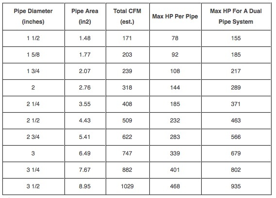

                  Click image for larger version  Name:	Screen Shot 2020-07-31 at 12.14.51 PM.jpg Views:	77 Size:	47.6 KB ID:	46997
                  There's two significant factors:
                  1) total pipe area
                  2) merge location
                  For (1), you only need enough that's it not a restriction. Swapping out the section 2 on a car with/near stock power isn't going to get you anything. Cheat sheet above. Stock is ~2.25" (dual).
                  For (2), the stock location is pretty optimal for 99% of people-- really good top end power with great low/mid range power. You have to be will to throw away the sub 5000rpm power band to gain anything at the top.
                  I like the SS twin 2.5" section 2 because it keeps the stock merge location, so it doesn't ruin to bottom end/mid range, which still flowing sufficiently for a full bolt on car (and then some). It also allow you to use a resonator, which nixes the rasp (which I dislike).
                      1) total pipe area
                      2) merge location
                      I like the SS twin 2.5" section 2 because it keeps the stock merge location, so it doesn't ruin to bottom end/mid range, which stiff flowing sufficiently for a full bolt on car (and then some). It also allow you to use a resonator, which nixes the rasp (which I dislike).
