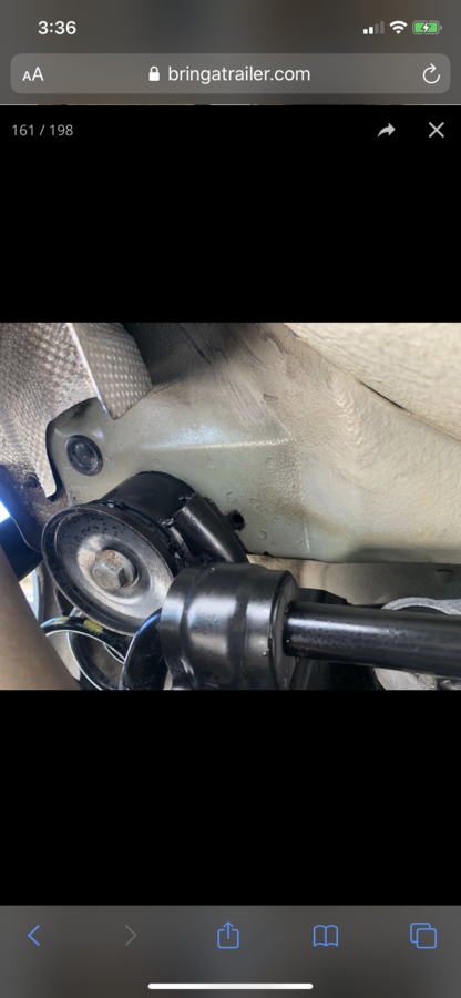

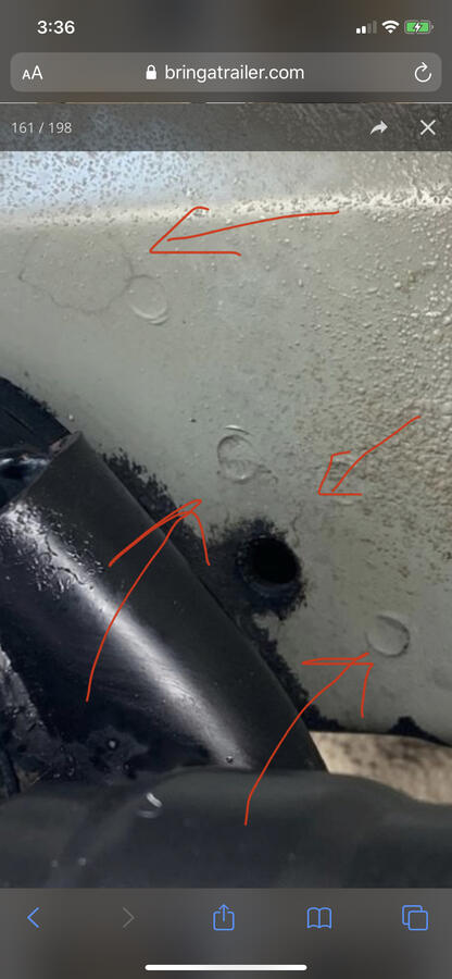

I was looking through the sellers photos. Originally photo 154 stuck out because of what I thought was a crack at the wave in the subframe. I took a closer look at photo 161 and I think it is just the light acting weird. However— also in 161, it looks like the spot welds are popping and there may be a hairline rack forming at the 2-3 o’clock position from the bushing. Am I correct in seeing that or am I a noob?

I see what you are pointing out. The problem here is it’s really hard to say with 100% confidence unless you remove that underbody sealer. My guess though, considering a very large portion of our cars have some sort of cracking, this one is likely no different.
Also, that’s why I hate the “subframe inspected” bs on all these ads lol. Until you drop the subframe and grinded off all the seamsealer, you’re not really going to be able to tell with certainty that your RACP is fine. So if you’re doing all that work anyway to get it all inspected the right way, you’re doing the reinforcement work while you’re in there

It was just something I noticed flipping through the photos. The spot welds appeared to be dark like they had popped and possibly some hairline crack (or maybe just some badly placed dirt). Since it’s not 1000% fractured, I’ll let it play out I guess and not risk damaging the sale for the seller.Originally posted by BMWahba View PostI see what you are pointing out. The problem here is it’s really hard to say with 100% confidence unless you remove that underbody sealer. My guess though, considering a very large portion of our cars have some sort of cracking, this one is likely no different.
those are water spots. I dont see any cracks...
if the car has a decent amount of miles, assume there are RACP cracks until proven otherwise..... take "subframe inspected, no cracks" with a grain of salt. depends on how inspected it and how it was inspected..... simply putting it on a lift and looking isnt going to cut it. you have to drop the rear end and remove the sealer to thoroughly inspect it... and at that point you might as well slap on reinforcement plates too.2005 Phoenix Yellow M3 Coupe 6spd

I just finished an extensive rear end refresh and reinforcement on my m3. I did many hours of research and with the help of reddish motorsport, it helped me understand the issue on this chassis regardless of year and model. I removed the seam sealer on both the trunk and underside of the car only to find failed spot welds in areas that would be un-noticed.
From what I've learned these are inevitable failures on the e46 chassis. My car has relatively soft kw v2 coilovers with only 200tw street tires, a hand full off track days with welded plates on the underside (thinking it was enough). It wasn't until I noticed the seam sealer cracked on the driver side wheel well upon routine inspection. That started my 8 week journey of hours of research, and quarantine project. lol.
Based on that BAT ad, the seller looks to have gone out of his way to clean the areas to show there are no cracks on the chassis. And take pretty detailed pictures. Based on the picture you provided, the top corner area looks like a water spot. The 2 lower spot welds with a mark can be questionable. I found areas somewhat similar on my car and upon taking it down to bare metal, is where I found the crack or failed spot weld. Again, I'm not saying it's a crack on that car. It would be hard to confirm without actually taking it to bare metal very carefully. Regardless, these chassis need to get reinforced anyway. I would say that the car is a good start, it doesn't have obvious cracks.
Everyone on this forum really should be aware that you NEED to reinforce both the bottom of the RACP and the top on the trunk side, whichever method you prefer, regardless of year. It's not just my opinion, I watched almost all the reddish videos and they show the different failures on this chassis regardless of year, mileage, model. Each varying in severity but all in the same areas.Last edited by enjoy_m3; 07-31-2020, 09:31 AM.
To me, there does look like a crack on the 2nd picture (2nd from the bottom red arrow), but can't really confirm based on single picture. Wish there were more pictures at a different angle to help.
