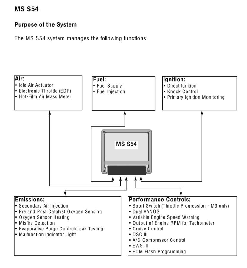

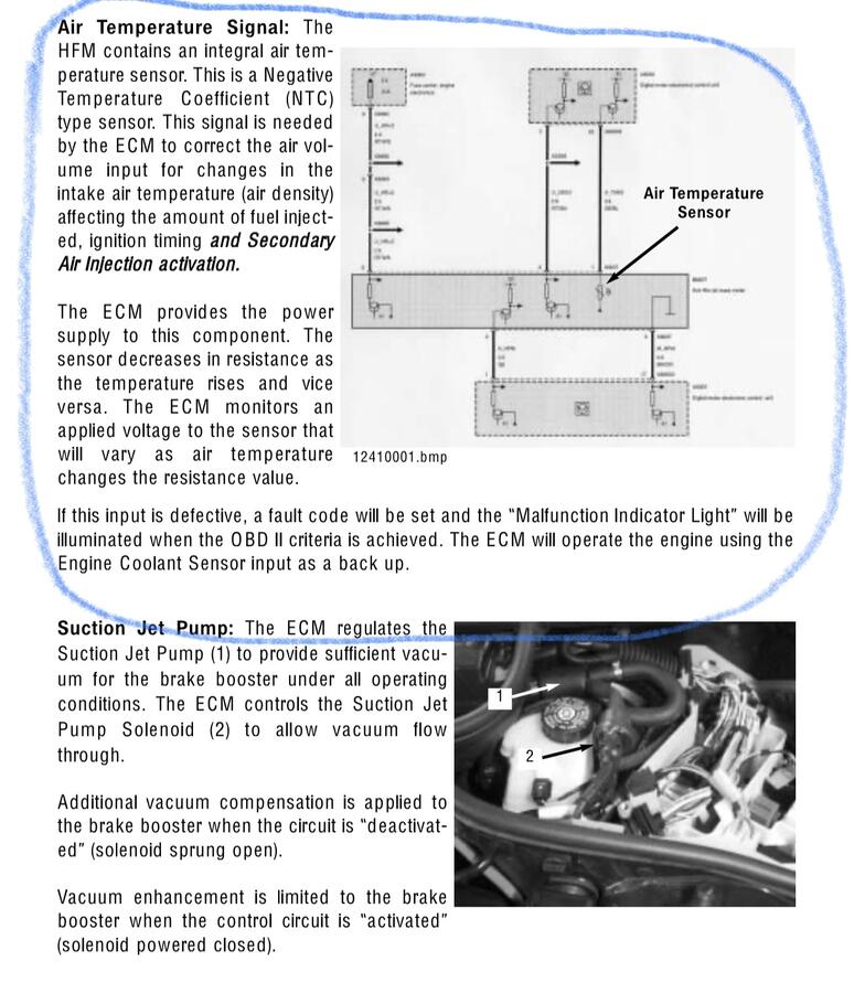

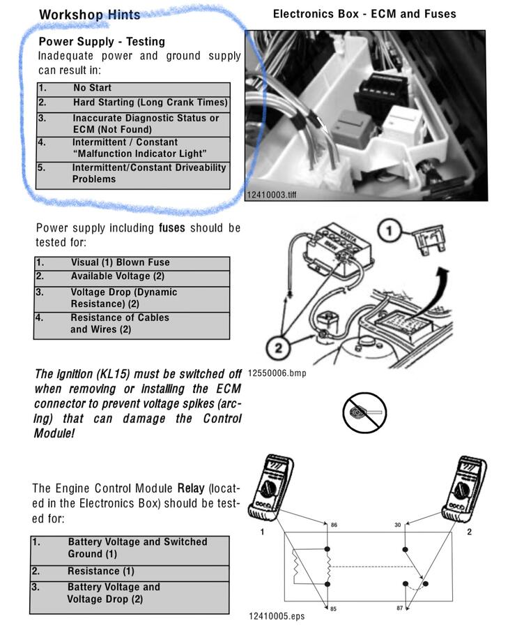

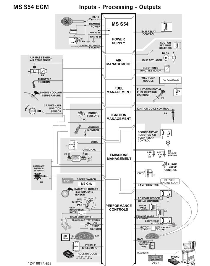

  • eacmen
    replied
    Originally posted by Speed Monkey View Post
    Dude, that’s a whole lot of questions, but there are many answers. You made me geek-out 🙄 and look through my PDFs; here is the info you seek. I hope it helps you.
ID:	48586 Click image for larger version
ID:	48587 Click image for larger version
ID:	48588 Click image for larger version
ID:	48589 Click image for larger version
ID:	48590 Click image for larger version
ID:	48591 Click image for larger version

  • Speed Monkey
    replied
