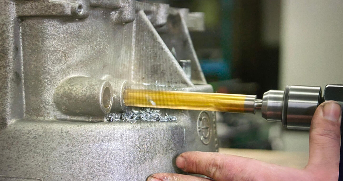

    and the newest Wheeler Dealers episode shows Lang Racing doing the conversion and it looks like they just drill it by hand! I've been trying to conclude what exactly needs to be done by reverse engineering that episode.

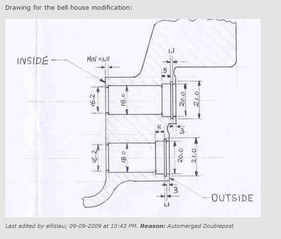

        Here is the drawing as mentioned above. I remember reading somewhere that it was incorrect though.

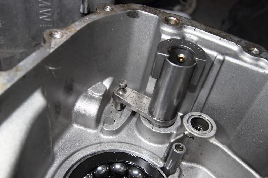

        And here is the 6MT bell housing:

            The guy in the e46fanatics thread I linked in the OP stated that the drawing was incorrect and that you could drill completely through. My only confirmation is the Wheeler Dealers episode as it looks like he drills straight through. The e46fanatics guy is MIA and hasn't responded to any texts (he left his phone number in his post).
            I'm most concerned about how the sleeves stay in place without the little lip shown in the drawing?
            Anyways I ordered the correct drill bit and I will document it all for science when I do it. I figure if I mess up the holes I will plug them and use a self centering chassis mounted shifter or something.

                1. Is the lip to contain the sleeve necessary? E46fanatics guy and Lang lead me to believe it is not.
                2. Is there a way to mill a c-clamp groove ala OEM? If not, that’s okay I’m going to use the hydraulic bolts like Lang and a guy in the comments of the original machining thread on M3F

                    For the sake of saving you the frustration i recommend you do not try a hand drill, you will wallow out out the hole and junk it. While lang is a competitor of mine i have enough respect for him to say he is not taking his rypbi to the bellhousing, its an industrial grade setup. This process requires precision with equipment that has next to no run-out.

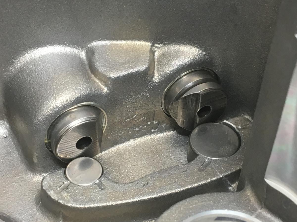

                    Most out there dont install the sleeves, or do it incorrectly. Pictures of presumably langs housing with no sleeves.

                            What is the part with the spring around it do?
                              Most out there dont install the sleeves, lang does not, or at least not on the fresh unit i have seen.I sure as hell dont agree with this method but you will probably be ok since you have plan b. Every cook has his method and margins i guess. What it looks like with no sleeves
                              That's the "you can't do this yourself" answer I was looking for. I haven't thought about the potential for run-out and I'm glad I didn't just go for it.
                              Now, I've got a drill press but it's likely not big enough and even then it'd probably have plenty of run-out. I'm going to do some further research before I put a nail in the idea.
                              In a perfect world (and one that I'd be throwing $500 on a bellhousing) I'd hope that the sleeves were in there. It's interesting that they aren't using them which means I could probably get away without worrying about the small lip people have mentioned.
