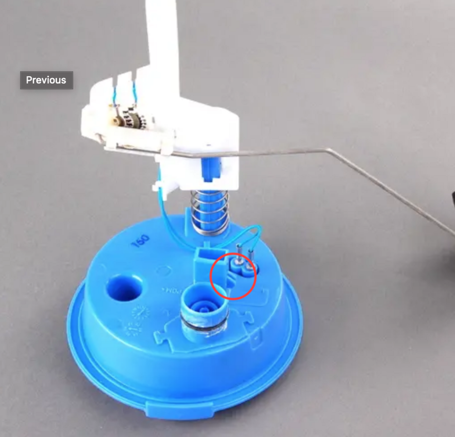

                    There is a small clip that holds the jet pump on the driver's side level sender that is plastic and can break over time. It can cause the siphon jet to fall off and not send fuel to the passenger side.
                    Click image for larger version  Name:	Screen Shot 2020-08-17 at 8.05.08 PM.png Views:	0 Size:	555.4 KB ID:	51001
                      What happened is the siphon jet or whatever thingy on the left side came off. Need to put back on. Pretty easy to figure out. Takes 15 min. Maybe 30 if you can’t get the screw ring off.
                        That might not work if the tab is broken. It will fall off again after a short drive. Easy inspection though as you stated jae.
                          This was my exact issue when I bought my m3. Was very well documented on m3forum. If you run out of gas at a quarter tank, this is the likely cause. My tab was broken so I replaced the sender.
                          The hidden cluster menu has a display showing the left and right tanks. Before replacement, left tank was as full or less full than the right. After fix, the left tank should be empty when the car is running and gauge is half or less. Being an eductor pump fed by the fuel return, it will always suck from the left and go to the right when the engine is running, only going back left if above the driveshaft saddle.
