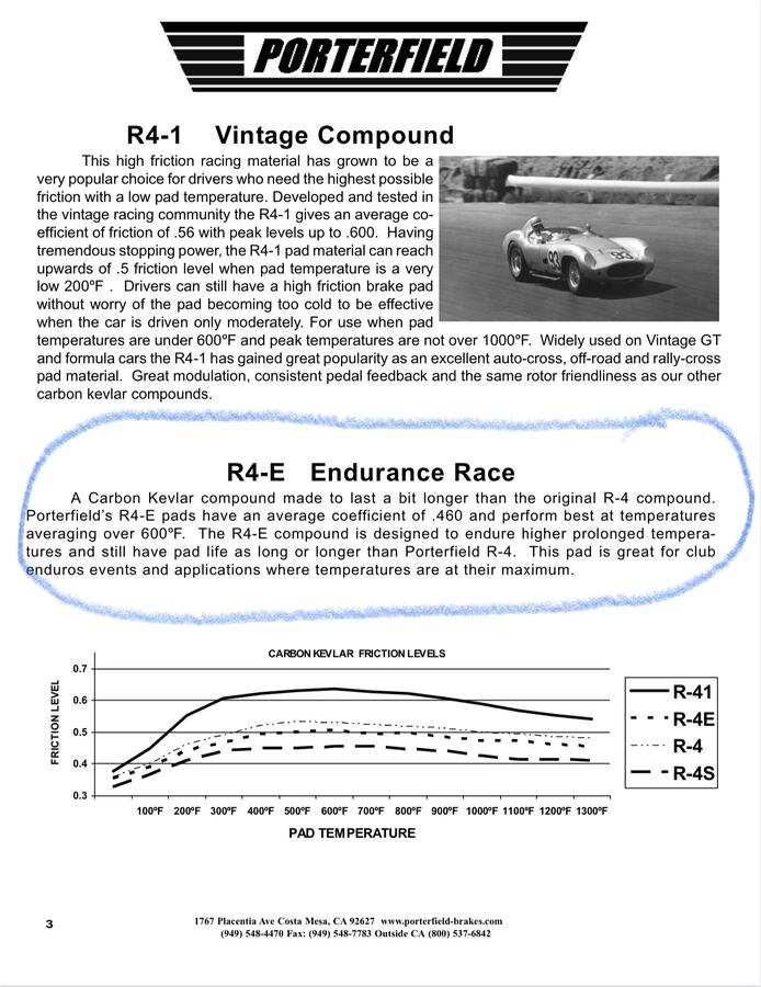

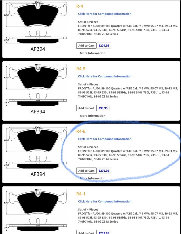

The peanut gallery chiming in here... Get standard Centric premium rotors, and Porterfield R4-E pads; when you hit the brakes with these pads, it’s like having a BBK when it comes to felt stopping power. Will stock brakes have the same thermal reserve as a BBK, probably not, but I’m just drawing a parallel to your post as it mentions least cost. R4-E will squeal upon braking, but so do the Ferodo pads in my 6 pot calipers. It doesn’t bother me, the noise that is. For something more street friendly, the R4-S is a great pad, and it is noise free, but it doesn’t generate nearly the brake torque that the R4-E pads generate.

Originally posted by Speed Monkey View Post[SIZE=14px][FONT=Arial]when you hit the brakes with these pads, it’s like having a BBK when it comes to felt stopping power. Will stock brakes have the same thermal reserve as a BBK, probably not
So any pad with a higher coefficient of friction (R4 e, PFC08, ST43, Ferodo, whatever) will provide the similar increased effect on stopping power, assuming your tires don't brake traction forcing ABS to kick in constantly, but not repetitively and will fade after a few hard applications when pushed (since you are converting kinetic energy to heat quicker but the thermal mass is too low to keep up with dissipation). So it will not function like a BBK because stock calipers can only accept the same size/format of the pad.
Sorry Monkey, not trying to sound mean, just providing more accurate info.
