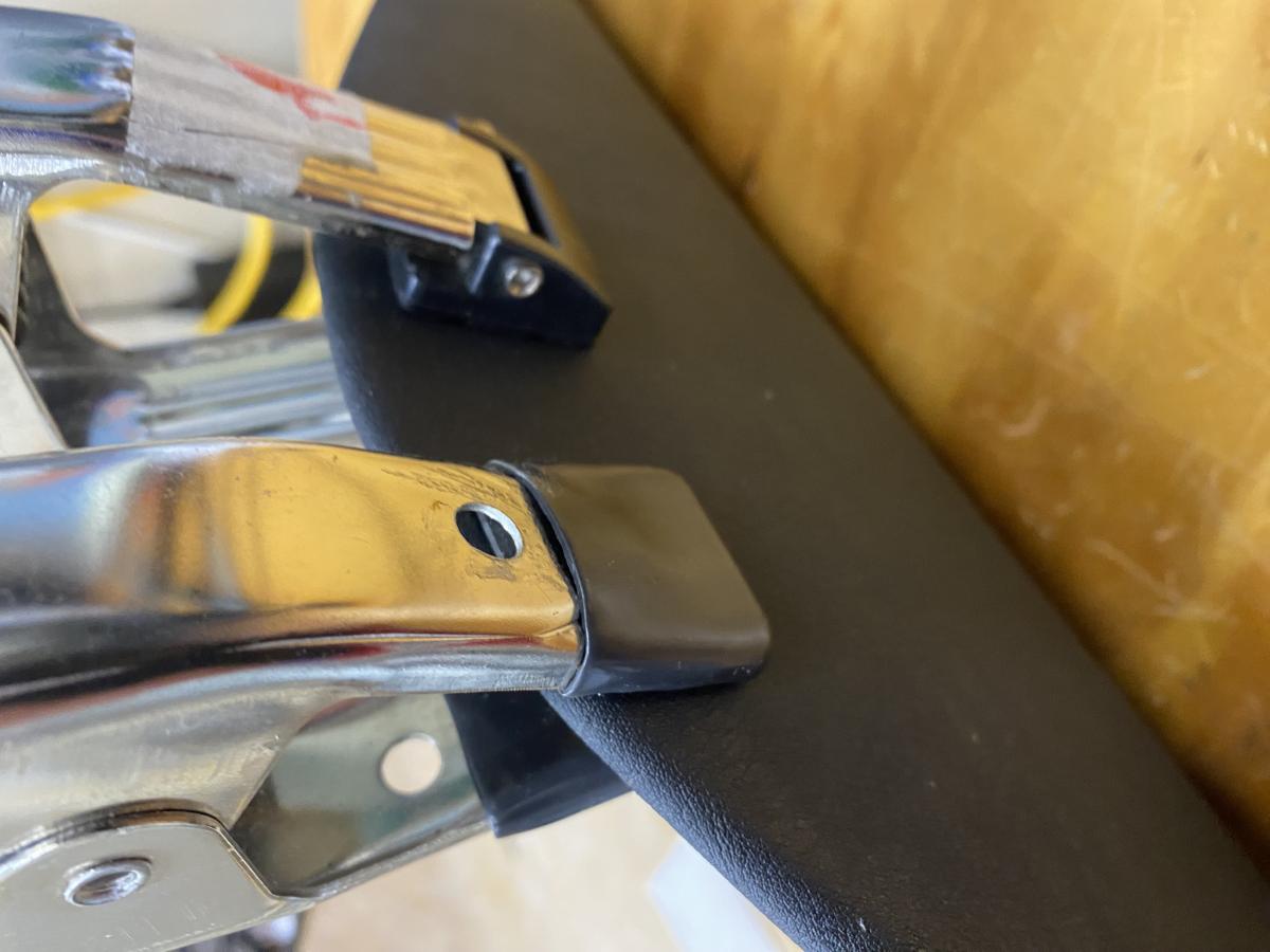

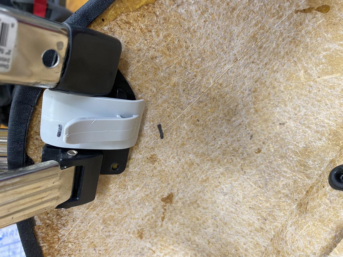

              I used JB Weld Plastic Bonder (https://www.jbweld.com/product/plastic-bonder-syringe) and have had good success. I reused the original clips but carefully removed the original glue as best as I could from the clips. I left the original glue on the panel so I knew where the clips went. You can clean up the surfaces with rubbing alcohol as well for better adhesion. The product cures very quickly - like within minutes - so plan to work quickly. After you apply the product to both the clip and the original glue on the panel immediately clamp them together and wait for a few hours. If you're short on clamps only mix minimal product and do it in steps. Clamping the clips to the panel for a few hours is imperative for great adhesion. Let me know if you have any question...

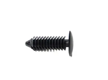

                I had same issue and my plastic clips were fine, just the glue came off. I did not want to buy the whole kit and was looking for just the one time use clips. Leaving the info if anyone has similar issue in future.
                BMW part Number: 52201964201 >>LINK<<

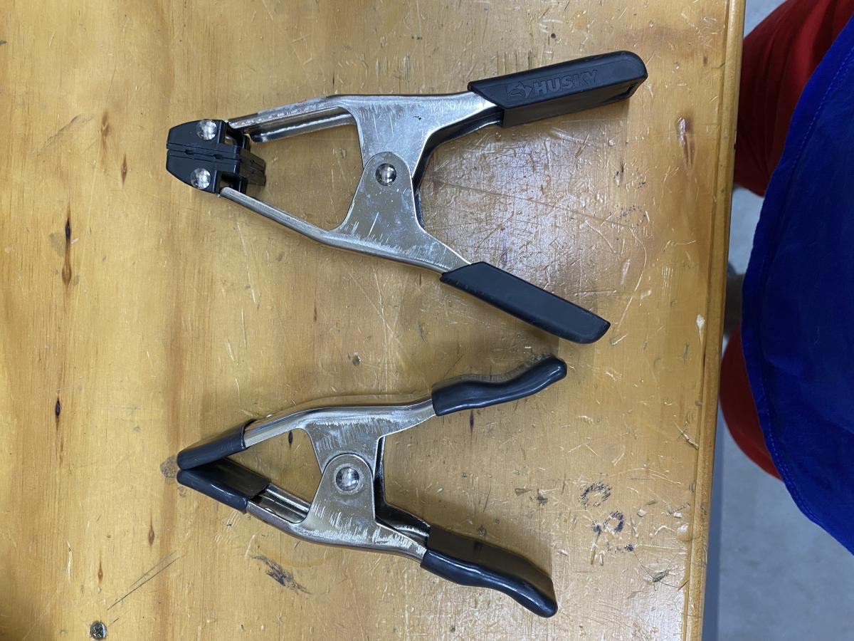

                    Sounds like what I need to do. Question: What kind of clamps did you use to clamp the clips to the panel?
                      You can use a combination of clamps like these that you can pick up at Home Depot.
                        Thank you for replying. Appreciate the info! I'll give it a shot.
