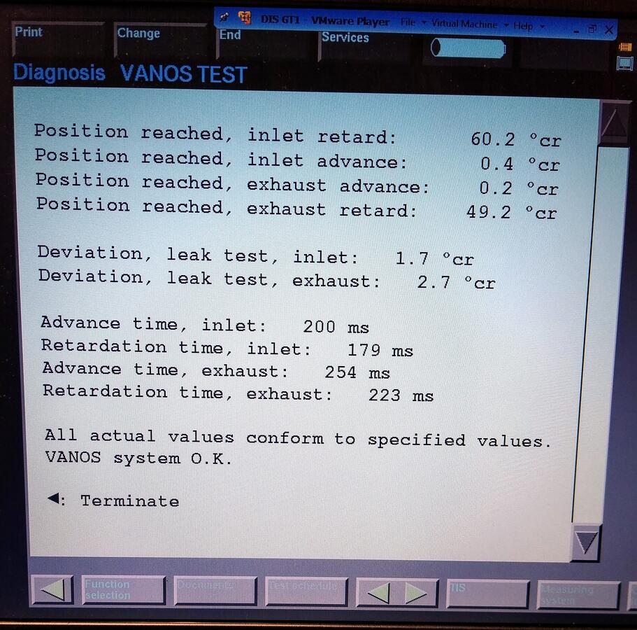

Vanos splined shafts "sweet spot"
Did mine in DIS. This screen shot doesn't indicate the adaptation values (I think it was a screen before this that I didn't record since I cleared adaptations after timing adjustment completion), but IIRC the perfect target numbers are 60.0 degrees for inlet retard, and 48.0 degrees for exhaust retart, and zero for each of the advance results. Looks like maybe my OCD is a little activated now...that maybe I was more like 0.2 and 1.2 (vs. 0.4), but I'll have to go back and check the DIS menus and what can be viewed.1 Photo
