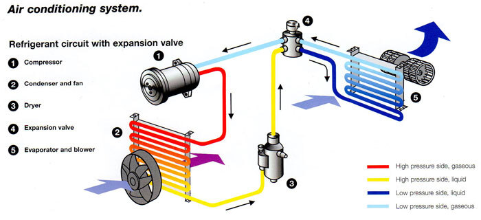

      When you guys say ”drier” do you mean the evaporator (P/N 64-11-9-135-744)? Is that in the front of the car?
      Which part is built into the housing under the dash that is a real pain to get to? I’m dreading that, should it need to be done.

          A simple basic vehicle AC unit:

              Thanks for the schematic, really simple and helpful. And yes, I’m generous with the miles haha but they filed up the tank, they really are doing this right.
