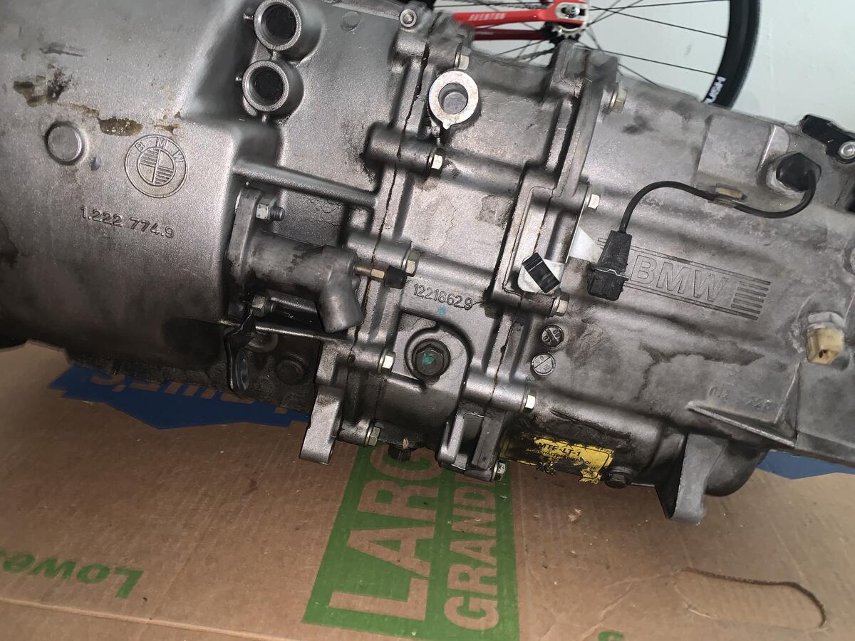

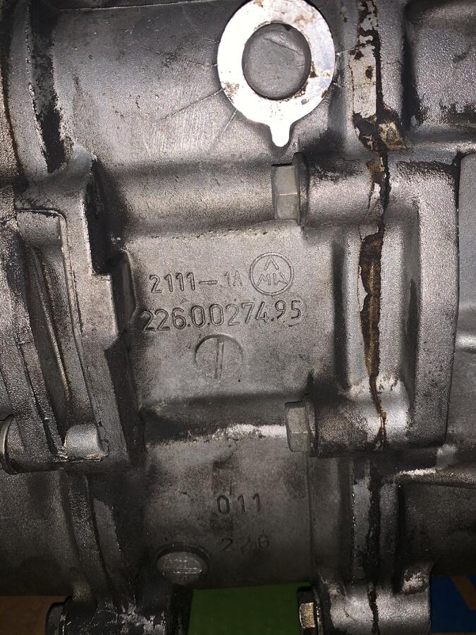

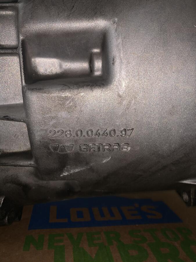

    Hey everyone!
    Can anyone confirm this as an OE E46 M3 Manual Transmission from the part numbers in the pics provided? I checked RealOEM and it says the part number for it is 23002229721. Also the yellow sticker shows MTF-LT-1? Please let me know thanks!
    Anyone?
      Best I can do is this short thread at e46fan that someone had the same issue and someone more knowledgeable than I sorted them out.
      Looking for the correct part # for an E46 M3 6 speed manual tranny. Not an SMG. Im looking at picking one up but the part #s are jiving. There are 2 part #s on the casing. 2260044097 2260027692 Any help would be appreciated! Thanks!:pimpin:
        It is a manual, it has the machined bellhousing for the pins and the threaded gear position switch.
