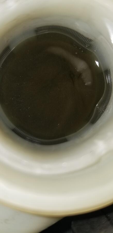

            MC is where the noise is coming from. Seems like the reservoir closest to the front "bubbles" or "gurgles" when pressing the brake pedal firmly. Brake pedal has normal pressure.
            Upon inspection, there is air getting into the MC as fluid is extremely cloudy and brown in appearance (even 3 pedal pumps after topping off with fresh fluid after bleeding). Bled all calipers & slave cylinder (slave cylinder replaced & not bench bled about 300 miles before noise occurred). Fluid from calipers & nipples is clear.
            Disassembled most of the right engine bay today to get a good look at lines running to the MC and to the housing just below the MC (not sure what this is, looks like SMG pump?).
            Note: Can replicate noise when "punching" the brake pedal.
            Images for reference.
