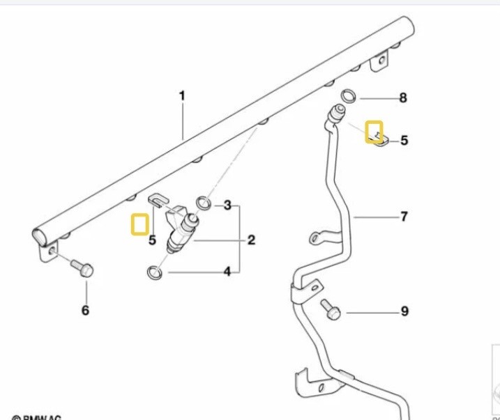

    Was changing out a fuel injector this weekend. Was looking over the ETK and see it says our fuel rail takes 7 clips. I swear I only removed 6, is there a 7th for the fuel line? Dang if so I better get another immediately. Here’s the diagram. Clip is #5.
    7th is indeed for the fuel line.
      Thank you for confirmation. I was hoping to hear there was a change in years. Time to go back in there.
