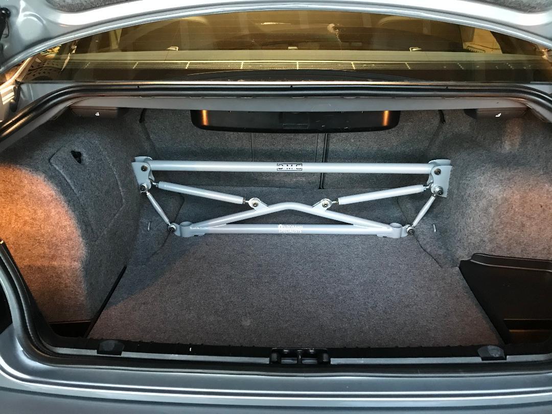

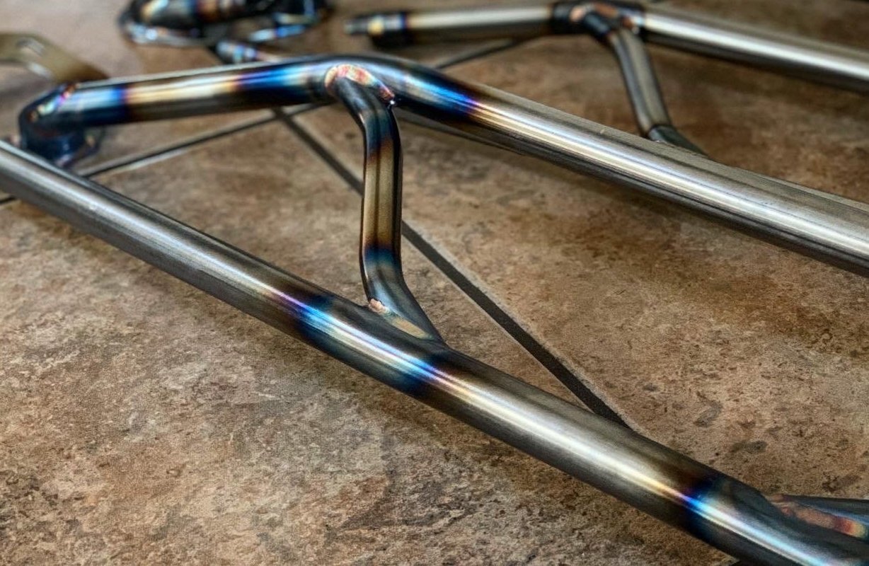

ID:	53356 I went with the DMG Autosport Subframe brace. My car didn't have any cracks upon inspection, so I went this route and couldn't be happier. You can really notice the increase in stiffness in the back of the car and the workmanship of DMG is second to none. Go to their website and check out the beautiful Welds on their braces, absolutely look like works of art. Click image for larger version  Name:	thumbnail.jpg Views:	0 Size:	140.3 KB ID:	53354
