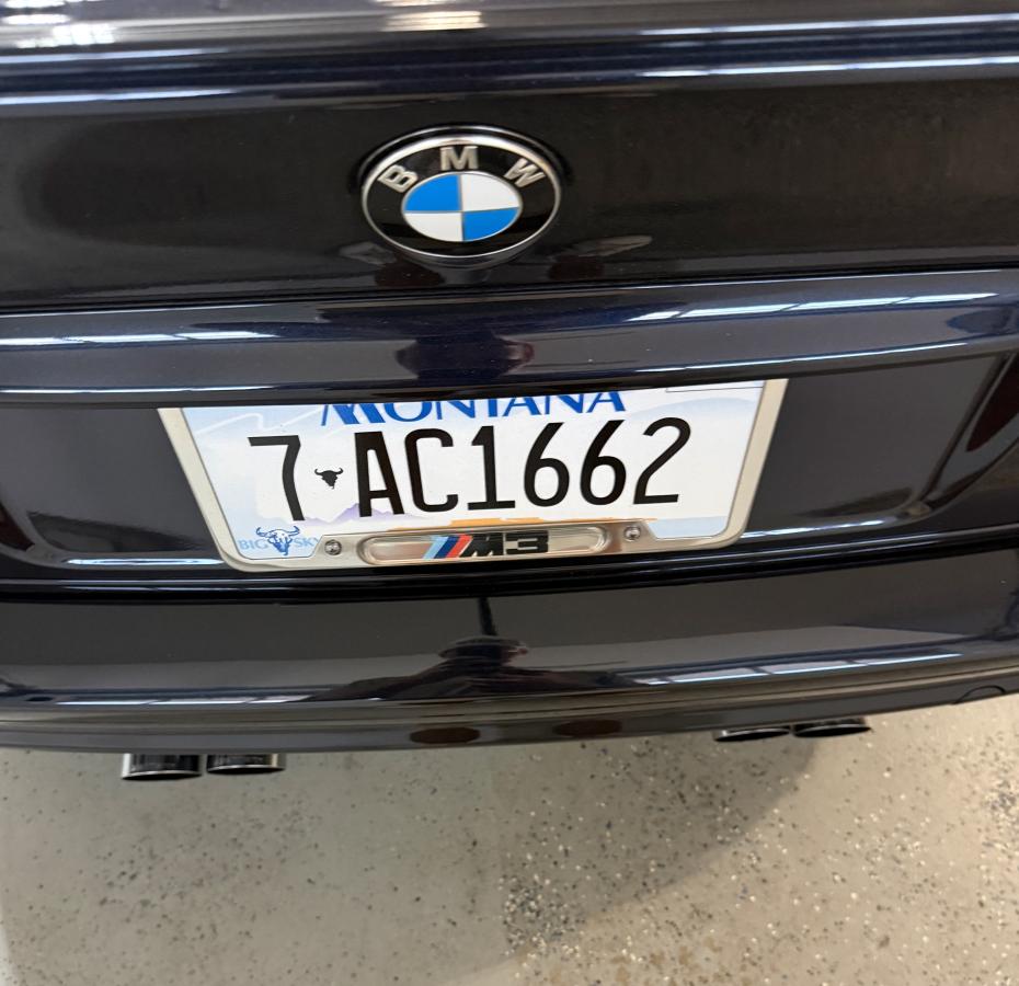

                    I'm currently dealing with a slightly crooked Eisenmann Race (76mm) muffler that seems to be caused due to the manufacturing of the Supersprint section 2 resonated x-pipe that I have. No amount of adjustment with the flanges solves it. I just ordered new muffler hangers and am going to experiment with orienting the left (driver's side) hangers the correct orientation (with the rubber mounting hole biased unloaded towards the front of the car) and the right (passenger side) rubber hanger flipped technically incorrectly with the bias towards the back. No idea if this will help but I'm hoping that flipping the passenger side would help counteract how the muffler is currently sitting slightly crooked rotated to the right.
                      Looking at your pic, I wonder if you can push Sect 2 more forward to bring that side of Sect 3 inward a bit. With SSV1s, you get more flexibility because the slip fit can be adjusted a bit. With standard euro flange connection, it might not provide as much. But I would try shoving the system as forward as possible. Then turning the driver side hangers in the orientation that pushes (or keeps) things towards the engine more might work. Then orientate the hanger on the passenger side as far back as possible.
                      The other thing I've done is to shove a rubber block into the rubber hanger to force the center metal bushing/sleeve in aparticular direction; in this case, toward the back to push the middle forward - does that make sense? I then secured that rubber block with a zip tie or high temp duct tape. You could also do the same to the passenger side, but put the shim (rubber block) on the front side to push that hanger backwards a bit more.
                      Keep in mind, the appearance of your tips will change from the car being cold to hot. Mostly, the exhaust extends as heat expands, but it might even push the driver side out more than the passenger (due to the exahust not being symmetrical [inlets on driver side]).
                      From you pic, I wouldn't really think about moving the metal bracket around. I don't think that would do anything. I'd focus on moving the sect2/3 joint forward more and the passenger side of the exhaust backwards more to even things up. But I'd judge the situation with the exhaust hot, not cold. Unless you care more about how it looks when it's cold, versus hot. Or maybe there's no difference. There is on mine (stock muffler with tips added).
