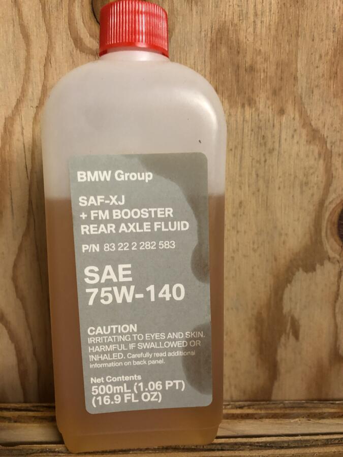

            Which diff fluid are you using and how old is it?
              I have found that nowadays the fluid dealers give is not correct as it doesn't have the FM that was originally spec'ed for our cars. Sounds exactly like the noise that my diff made when I purchased diff fluid from the dealer the first time, I searched out the correct fluid with the FM in it and within 100miles of driving the noise was gone.

                  This is the fluid I’m running, not sure exactly when I changed it but less than 2yrs and barely any miles. I’ll do figure 8s again and double check the level. Click image for larger version
