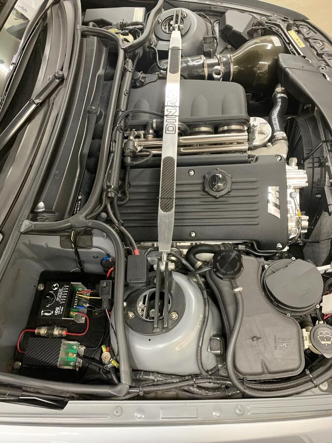

  • S14
    replied
    Exactly...😎
    Spal Fans: 20 mmH2O (See Post #21)
    Hence the reason I went with the Spal 2082 with the Aux Fan still in place.
    2049: 389 cfm at 20.6 amps
    2021: 702 cfm at 19.5 amps
    2082: 991 cfm at 24 amps
    nice setup, what mounts are those for mounting the fan to the radiator?

  • WOLFN8TR
    replied
    For comparison:
    Spal 30102049 pulls 19 amps.
    High flow Mishimoto 16" pulls 18 amps.
    Skinny Mishimoto 16" pulls only 10 amps (*snicker*)
    Exactly...😎
