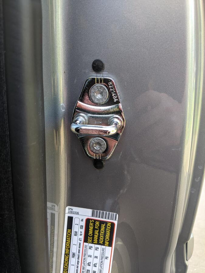

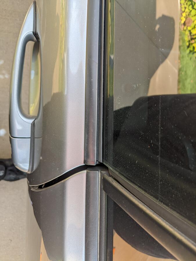

I feel like my driver's door is sticking out too far. How can it be adjusted?
How do you adjust the driver door
Loosen the screws just enough to allow movement, not much at all. Same with trunk alignment.
You can also put a little strip of tape along the outer edge to show where it was so that you can gauge your movement inward.
That said, your door looks fine. Looks more like the trim not lining up ?DD: /// 2011.5 Jerez/bamboo E90 M3 · DCT · Slicktop · Instagram
