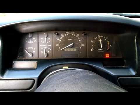

This video portrays the sound perfectly. Skip to 1:20 through this retard revving on a cold start.
Starting engine, running engine, throwout bearing soundThis is my Unbuild Journal and why we need an oil thread
