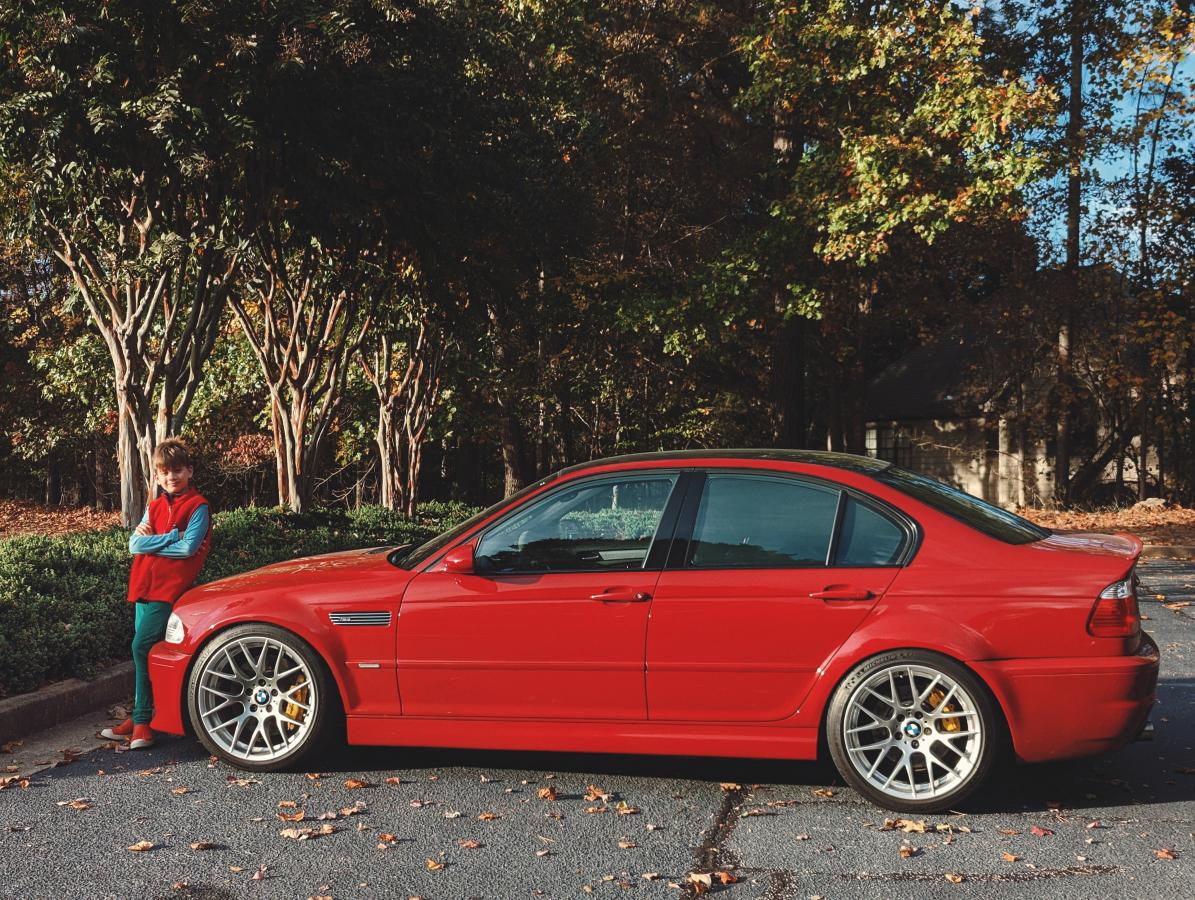

Love those wheels. I had a set of the machined finish on my E36 as track wheels. I have continually harassed them about making that finish available for all the 18" sizes, sadly to no avail. Regular silver paint would also be better than the gunmetal or black IMO. Looking forward to seeing these once you refinish them.Originally posted by Gt4 View PostBought Bimmerworld TE16 wheels from a member here. They look better in person than pictures IMO. Really like them. Going to respray them in silver.

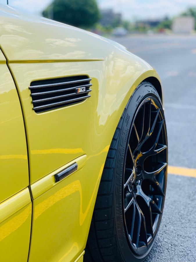

Can anyone chime in on what it’ll take to run this setup? Camber settings, fender modifications etc.? Really like this look and like to do on my e46 M3 but not sure how doable it’ll be. Appreciate any feedback. Thanks!Originally posted by nextelbuddy View PostStock e9x ZCP 359M wheels.
19x9 - 245/35/19
19x10 - 265/35/19
Max out negative camber front and rear with the stock hardware, lowered suspension and no more than a 245/275 street tire.Originally posted by mdefalco25 View PostCan anyone chime in on what it’ll take to run this setup? Camber settings, fender modifications etc.? Really like this look and like to do on my e46 M3 but not sure how doable it’ll be. Appreciate any feedback. Thanks!
- Likes 1
It doesn't take much at all to run this setup. It fits like a glove. I have had those exact wheels for several years now. 19x9 +35 with a 5 mm spacer in the front (basically +30) wrapped in 245/35 and 19x10 +25 rear with 10 mm spacer (basically +10) wrapped in 275/30. Car is slammed on eibach coil overs with no front or rear camber and front has zero rub. My rear fenders are rolled and it only rubs if I am exiting a steep driveway at a sharp angle. In regular driving, it has never rubbed for me. Again my rear fenders are rolled but I am also running 10mm spacer in the rear. My ride height is at 13" center cap to fender front and rear. fronts wont rub even with a passenger but rears will rub with a passenger on either side (with 10mm spacer). I used to love the way it looks but nowadays it is just too aggressive for my taste and soon I will be switching to a more conservative look with CSL reps 8.5/9.5 and raising the car. I'm going after a thick side wall with a mild drop look vs the stretched thin sidewall slammed look. If I don't like black CSL reps then ill go back to these same wheels and run 255/35 and 285. Black M359s just suit PY so well !Originally posted by mdefalco25 View PostCan anyone chime in on what it’ll take to run this setup? Camber settings, fender modifications etc.? Really like this look and like to do on my e46 M3 but not sure how doable it’ll be. Appreciate any feedback. Thanks!
