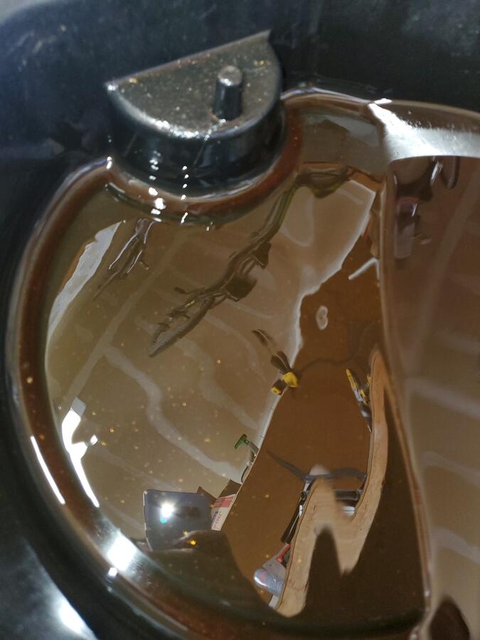

            My car had 110k miles and I don't think it had ever been done. The fluid was coca cola brown and I got an alarming amount of metal out of it. I ended up flushing it a few times. Allegedly there is a filter in the bottom of the PS reservoir but I don't think it does much. I changed my reservoir regardless. Click image for larger version
              I think it's only there to stop contaminants getting in when fluid is added.
                No filter, the white disc is a diffuser to diffuse high pressure oil returning into the reservoir. The reason why fluid spills out of the hole is pressure in the return from running at high rpms. Not heat and thermal expansion.
                Do change the reservoir since there is probably a lot of crap under the diffuser.
