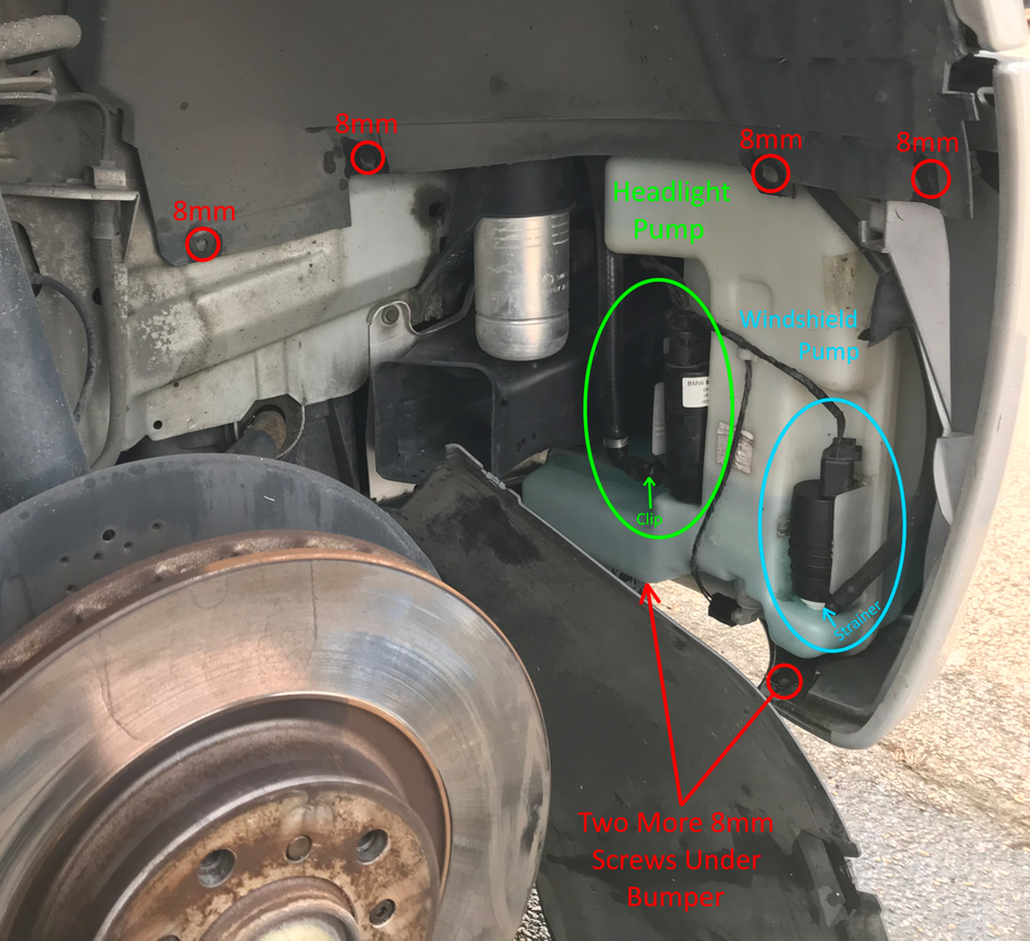

    3. Remove the front lower panel of the wheel liner by removing the 8mm screws around it and underneath the bumper. You may not need to fully remove it to access the washer fluid reservoir and pumps.
    4. Locate the pump you need to replace. They are fairly different looking, but the windshield washer pump is the one farther right.

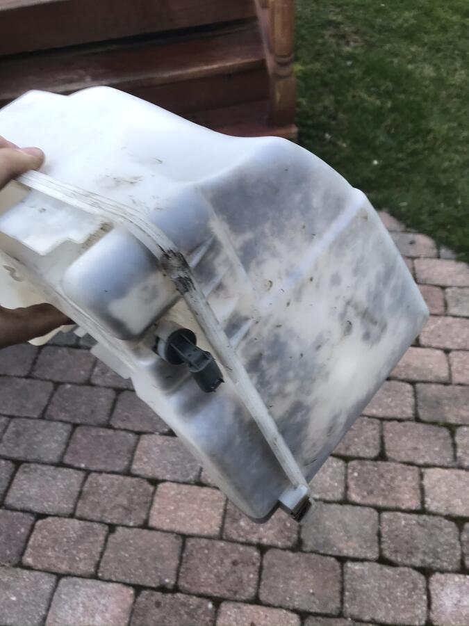

        I've been fighting a seemingly intermittent leak on mine as well. Mine's leaking from where the pump connects to the tank. Like Stepsools said above, I think mine is just popping out of the friction-fitted hole since there is nothing else holding it down. I keep having to get in there and make sure it is flush to the tank.I just ordered a new rubber gasket (61667006063), thinking maybe my rubber is old causing it to pop out easier. If that doesn't work, I'll have to think of some other way to hold the pump down more permanently.
        Only other thing I can think of would be fluid level sensor on the bottom of tank, pictured below. This pic was taken yesterday and it's currently filled with degreaser to get rid of all the mold in my tank.
