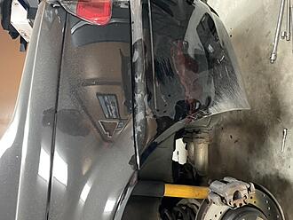

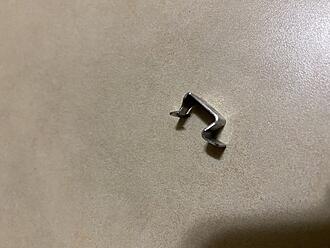

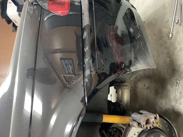

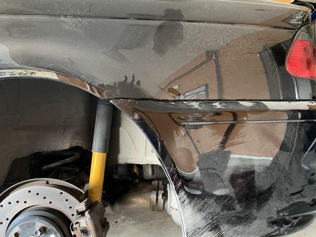

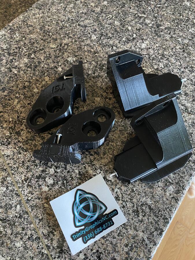

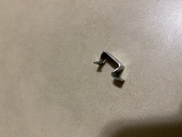

    I picked up a set of these brackets to help with my rear bumper gap. They did a great job of closing up the gap and are much stronger than the originals. I would highly recommend them but now I don’t know how to install the metal clips that hold it in place. The originals were long gone...any ideas?
    Click image for larger version  Name:	5CB12CF0-C684-475F-9634-9338BBA33029.jpeg Views:	0 Size:	79.5 KB ID:	57948 Click image for larger version  Name:	5EC9E6F0-F443-4F18-BD1B-268BA2BB99E4.jpeg Views:	0 Size:	79.8 KB ID:	57946 Click image for larger version  Name:	EDF7245A-E129-4CE0-843F-544E6D6AA8DA.jpeg Views:	0 Size:	84.7 KB ID:	57947

        Brackets can be found on this website: https://trinitygraphicsnc.com/

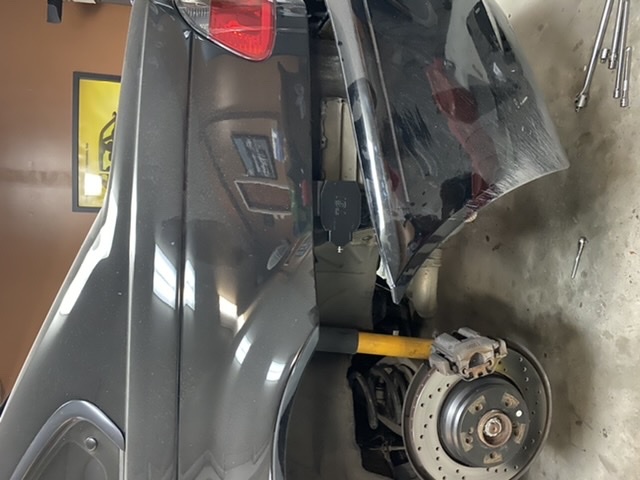

        I gave up on the clips and drilled a hole to run a zip tie through. I was able to pull the bumper cover up that way enough. I’ll replace the cover this winter as the previous owner messed it up where the diffuser fits.

            I was trying to access this old thread because I think it shows the older style clips that my car uses but it was lost with m3forum
            the newer style clips have a hook that goes on a bolt mounted in the fender. Part numbers are
            51127896161, 51127896162.
            the older clip part number i believe is 51124015053

              The hole is on the inside of the bumper cover liner and wouldn’t be visible except I went a little too far. I just need it to last until the weather turns cold and I can replace it. I don’t want to lose it while racing and the last events of the season are coming up.
