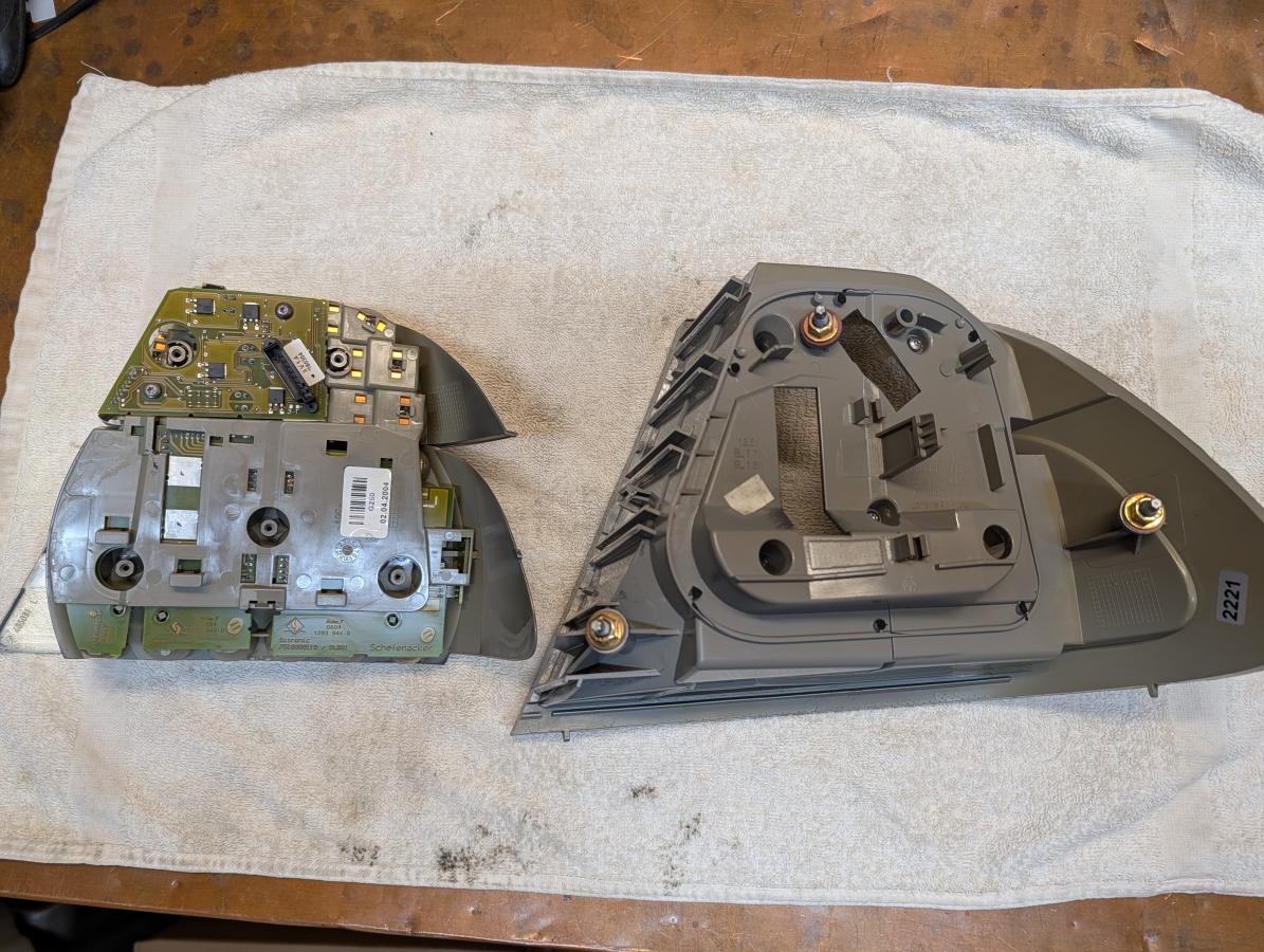

            Well so far so good...
            Separating the lens from the housing was *very* easy. Just a heat gun and some patience. Came apart in under 15 min and I was going slow.
            Onto the LED job.
            Click image for larger version  Name:	PXL_20260101_175228461.jpg Views:	0 Size:	199.5 KB ID:	331845

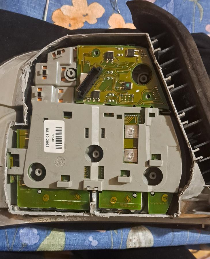

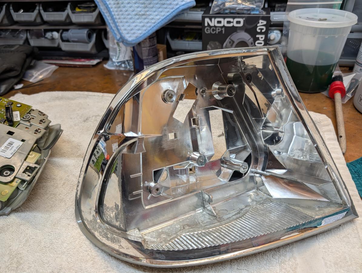

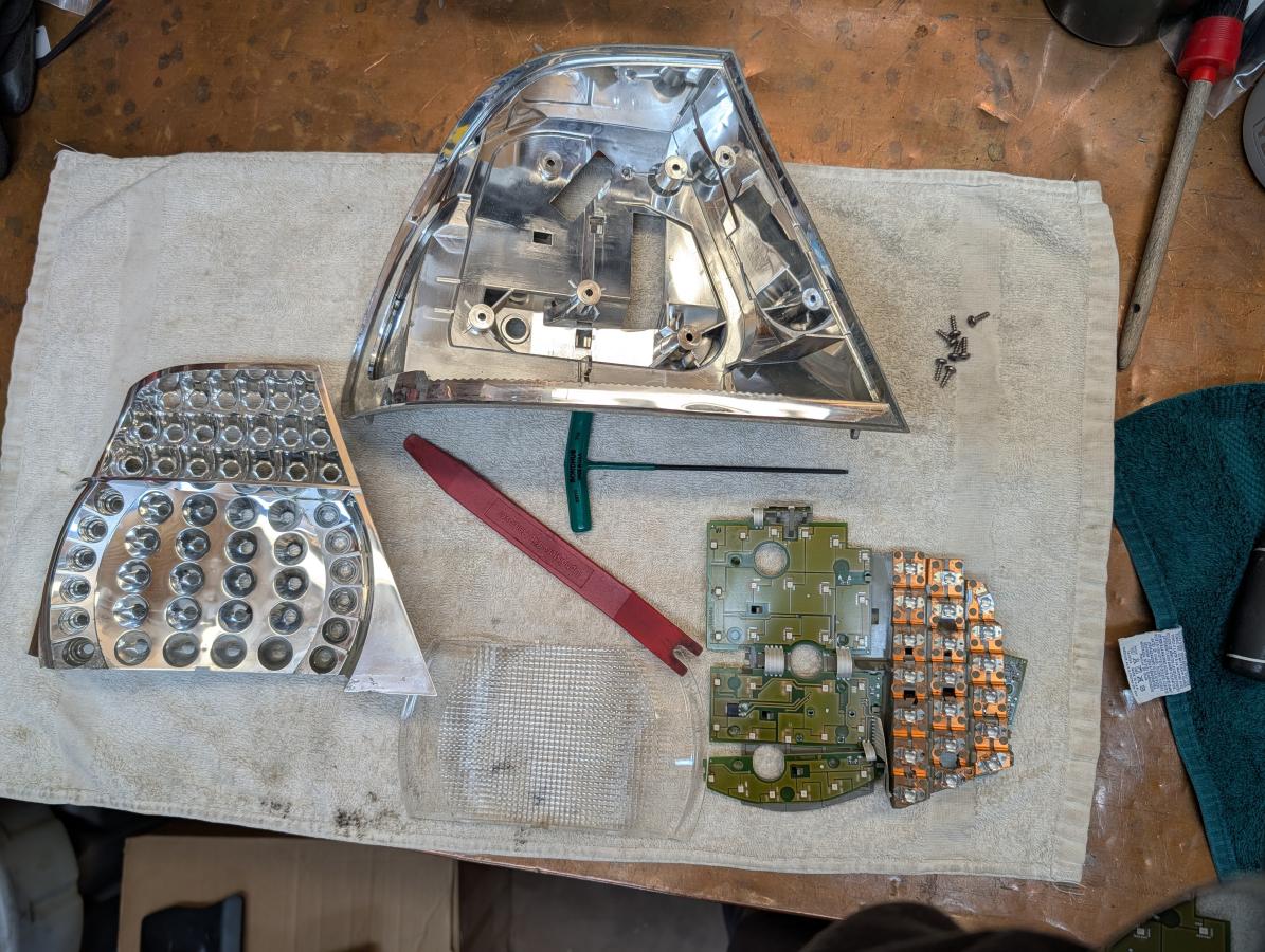

              So as it turns out, you 100% can get into the taillights without cutting into them. However, the lens needs to first be separated from the housing.
              If anyone is attempting this, I HIGHLY recommend removing your lens. The adhesive on both taillights I disassembled was very old and dry rotted. I suspect this will become a "routine maintenance" item for those with water leaking into their lights (or who want to preventatively address it) and not wanting to spend $750 per light as these cars continue to age.
              I'll add to this DIY or maybe even do a separate one (how to disassemble LED taillight housings), as I took lots of detailed photos and went slow so as not to break anything. Which, in 20 year old plastic, is quite easy to do. I tested several techniques and went until I heard plastic cracking, then backed off. There is a way to get these apart without breaking a thing.
              Here's where I'm at currently, out of time to progress this further this weekend.
              Click image for larger version  Name:	PXL_20260104_194237479.jpg Views:	0 Size:	206.1 KB ID:	332186 Click image for larger version  Name:	PXL_20260104_192027303.jpg Views:	0 Size:	186.5 KB ID:	332187
              Click image for larger version  Name:	PXL_20260104_191940068.jpg Views:	0 Size:	186.3 KB ID:	332188

                #52
                Another thought here. At this stage of disassembly, it would be easy to get the chrome plastic recoated if anyone knows if that's possible. It's on my list to research. The chrome on the taillights I acquired has seen better days.
