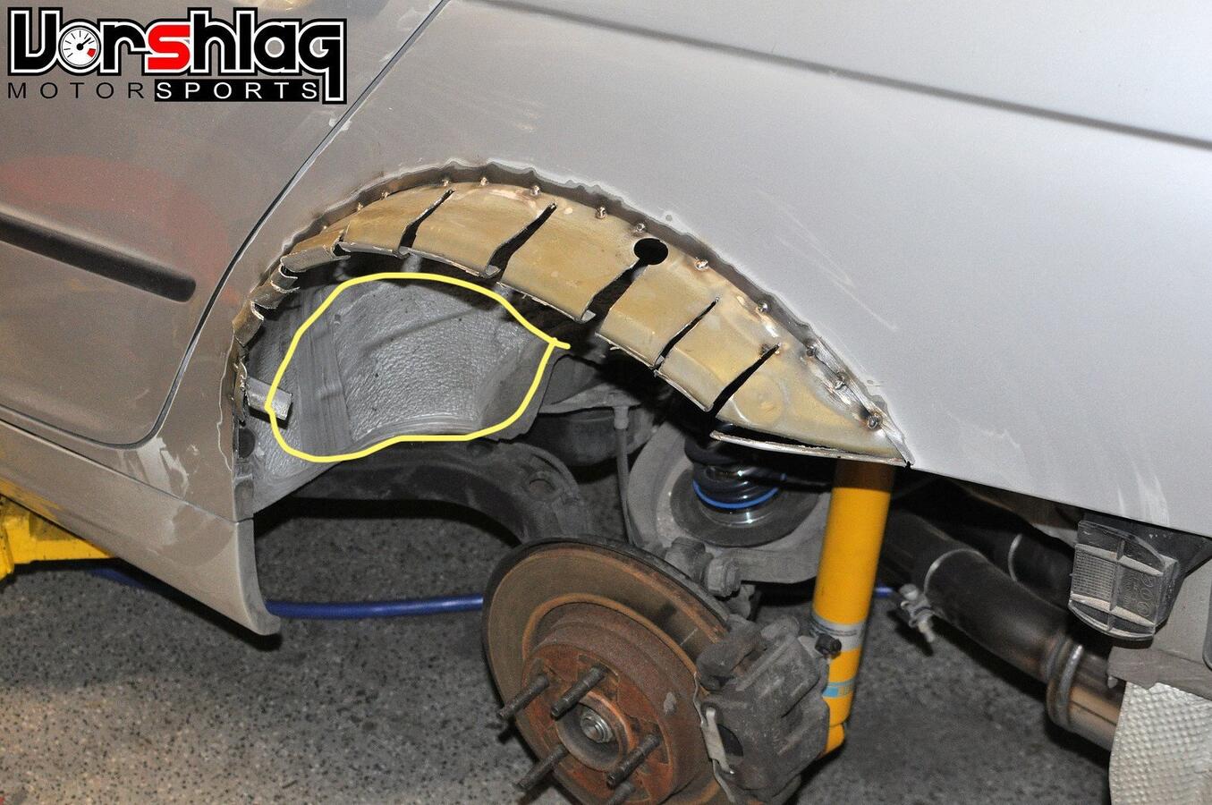

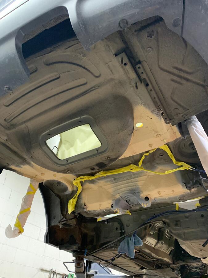

    Edit: I dont think I was specific enough in my description. Im looking for a rubberized type of undercoating. Ive circled a photo of stuff similar to what im talking about. Also attached is a photo from my subframe reinforcement. You can see they sprayed it everywhere and it dries to a protective rubberized texture. Thanks!
    Edit 2: I think I found the same product used on my car. 3M 08889. I'm going to order it and will update with how things turn out. And because i'm crazy, i'm going to put some Por 15 underneath the undercoating.

                    The 'rubberized stuff': should be SEM #39793 "HEAVY TEXTURE CHIP GUARD" Opaque. I can't believe all the different paints etc were required when i did my subframe reinforcement 5 yrs ago. BTW all the undercoating sprays, sealers etc. I've used have held up very well.
                      If i recall, the order: seam sealer the welds etc, then self etch primer. I THINK I applied the Light Green 62233, and last the Chip Guard. Reddish has a video on this. I followed their recommendation.
