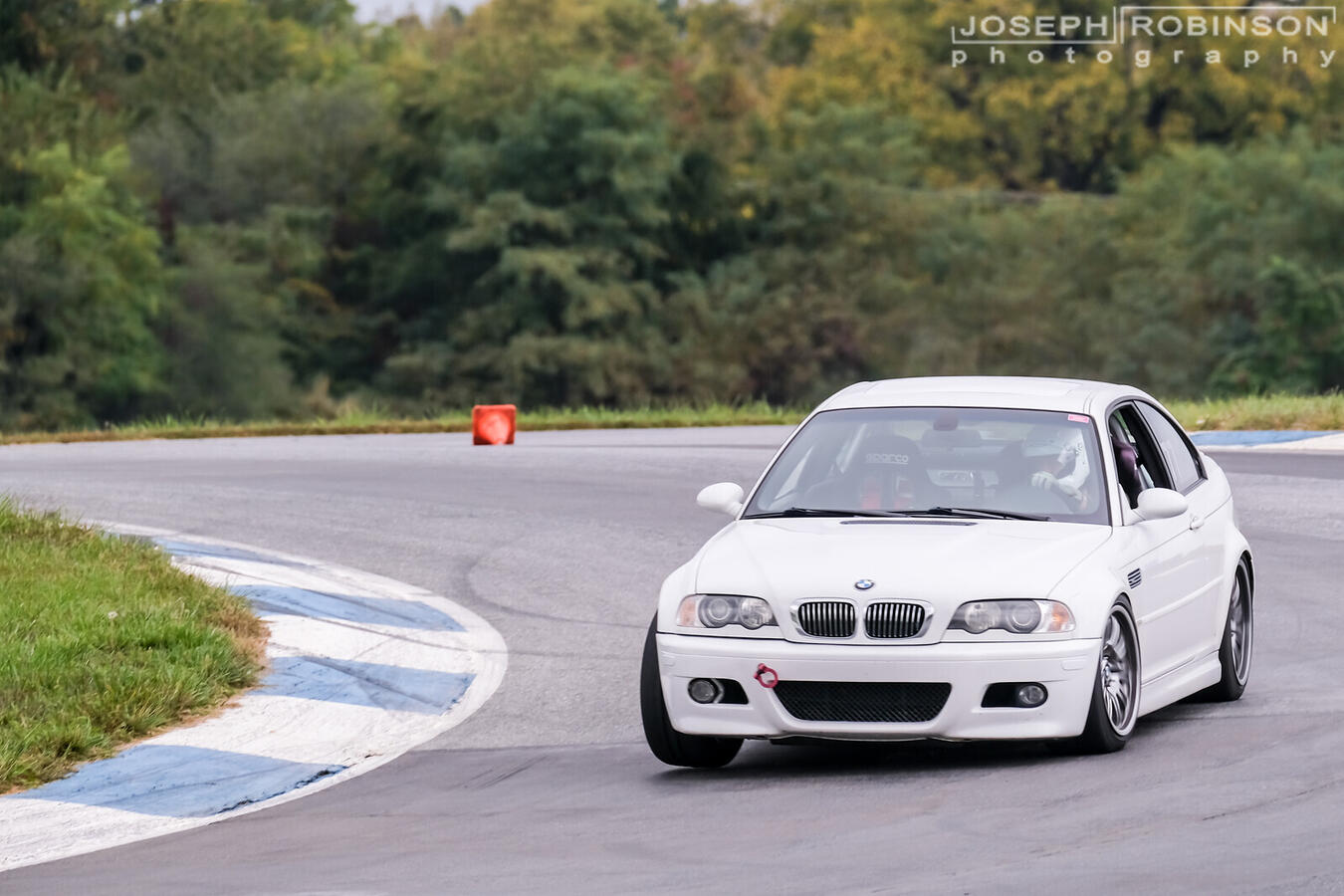

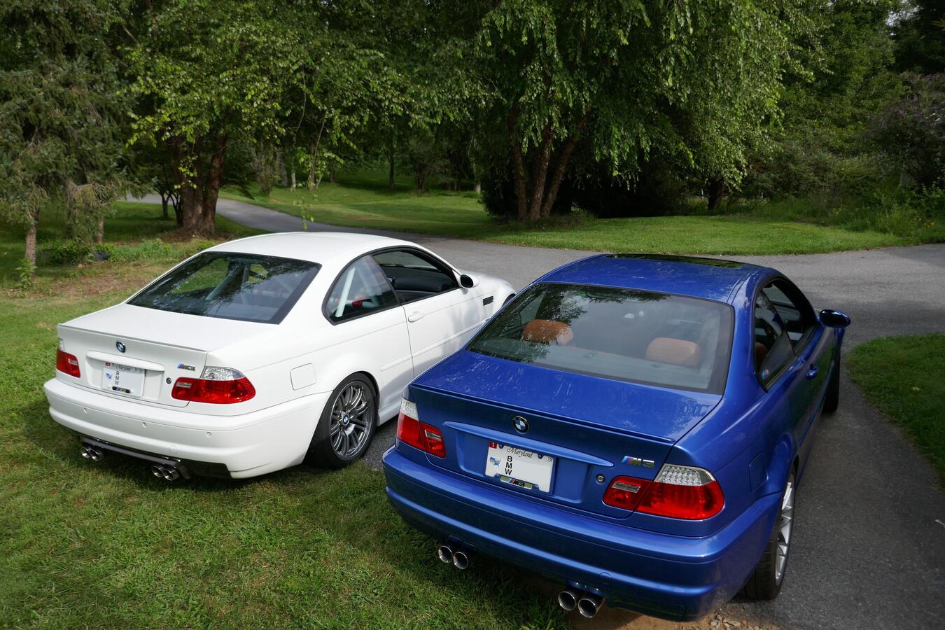

          I did a vinyl wrap on the CF insert for my track car. Did a DIY - first wrap of anything I ever did. The specific adhesive is white, so there is no black line. A very good match

              This looks great! What panel did you use? And what adhesive?
