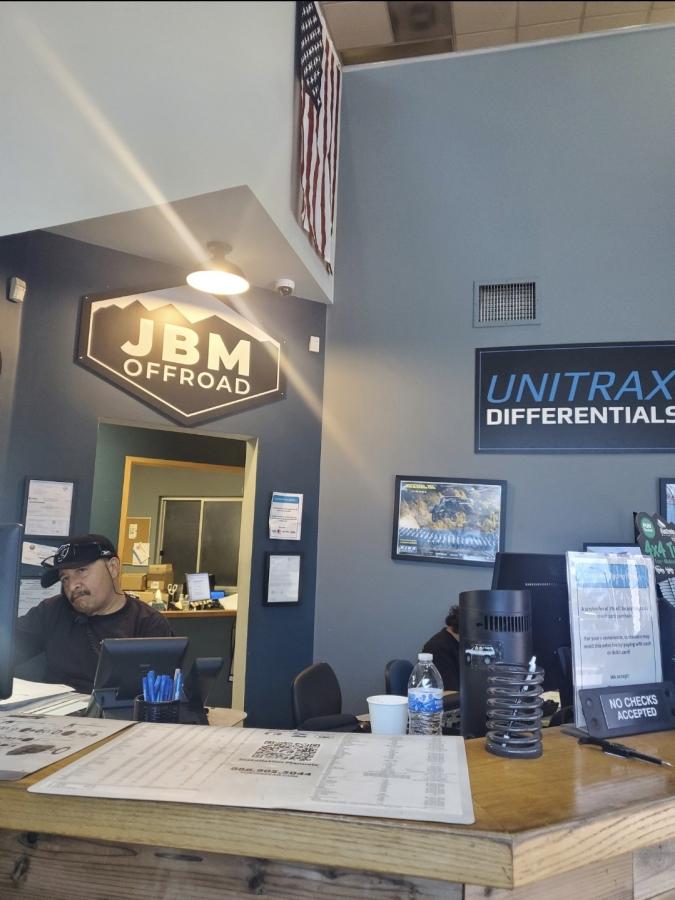

                          Called Unitrax, they're off Serfas Club, did a great job. I just gave them the ring, pinion, and seals etc and they swapped it out and rebuilt the diff. It's around $650 if you take the diff to them, another $350 if they take the diff on and off the car (what I did). I did a night drop-off i.e. left the keys in the door via a lock. Service is good and the work itself I'm happy with, they get the details down. Eddie is the head differential guy. Fyi I'm not affiliated in any way etc.
