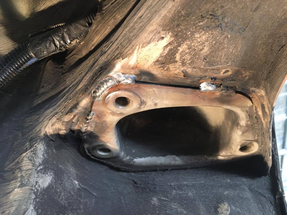

              I suspect braking torque is the biggest contributor to popping spot welds. The inner most bolt sits beyond any spot welds so it can pry on them and concentrate stress on their edge.
              I've just stitch welded that edge as well as the back and front of the straight edges when I have performed reinforcements. Dug up an old pic from a 325ci I did a while back.

                I've seen a couple now starting to separate, nothing huge and small enough most people wouldn't notice it. But now that I've seen it it happen the pockets always get inspected.
                And when I do a RACP reinforcement the pockets get stitch welded as part of that service.
