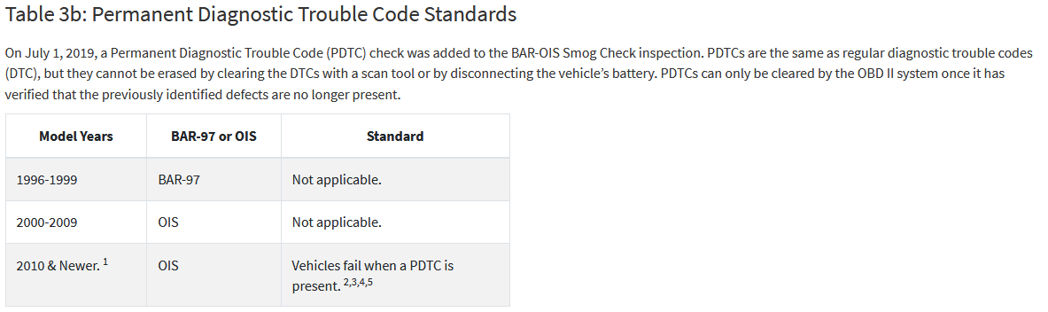

        Interesting. I think what cbean is referring to is the "Permanent Diagnostic Trouble Code Standards"
        Click image for larger version  Name:	Screenshot_2020-10-30 On-Board Diagnostic Test Reference - Bureau of Automotive Repair.png Views:	0 Size:	35.0 KB ID:	65193
        I think the e46 may be exempt from this as it is in the 2000-2009 period...

                  Mine passed 4 months ago (with an Epic Motorsports tune) with the stock airbox, euro headers & cats, with stock internals and knock on wood I haven't received anything in the mail other than my new tags shortly after the test. Hopefully its just Table 3b that's shown above that applies, or if the smog tech sees some glaring errors (as pointed out above "Plugging into an incorrect vehicle to perform the OBD inspection, or a tampered OBD system (I'm assuming running any kind of simulators in place of deleted emission control devices, etc.), can cause this failure.") that will raise red flags?
                  I looked over that Smog Check Reference Guide cbean provided and noticed some interesting information on Table 1, page 4:
                  • it looks like they MAY put our cars on the rolling dyno to do the sniffer test only if "there's a problematic OBD-II system" (under superscript 5, which states the following: "In the future, BAR may identify some vehicles that have GVWR of 14,000 and less or that have problematic OBD II systems that may require the BAR-97 test").
                  also cbean, sorry...I think regardless of how old are cars will get, they will not be exempt from smog checks.
