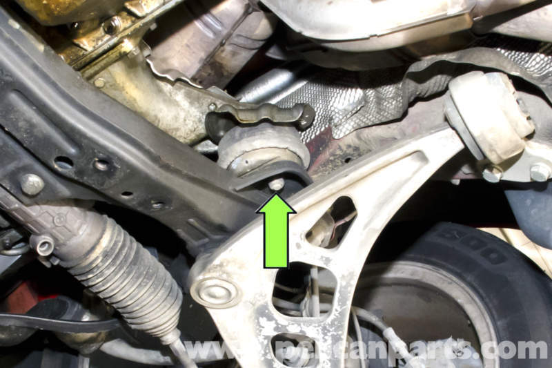

                      Here are 2 pix of the left engine mount that's 2 years old, and about 7K mile on them. I'm not sure this counts as collapsed, but it looks thinner than I recall when new. My comments about this whole episode are: the mounts should have lasted longer than they appear; this is a respected shop ( I thought) in the Phoenix area, and they should know that the stock SMG reservoir alone on S54 engines isn't replaceable, but that was their recommendation; I asked for an engine oil sample and got trans. fluid instead; I clearly asked for the brakes to be flushed and refreshed, had to catch that at payment time. I don't mind paying the cost for good work or decent parts. Sometime I use OE, sometimes not, and I can do most wrench jobs myself. I'm just giving the results of my experience with this shop.

                        I don’t see a motor mount in the two pictures you posted. I only see the ball joints that are built into the LCA. The motor mounts are higher up.
                          Agreed, looks like balljoint on the control arm.
                            The below is what you want to see. These are old ones, compressed, when changed at 98k miles on my car.

                              Ball joints look great. 🤣
                                You're right! My bad trying to get a picture without any lifting of the car. Will get to it in the next few days.
