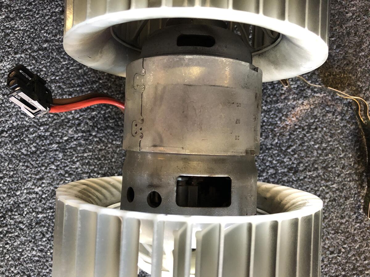

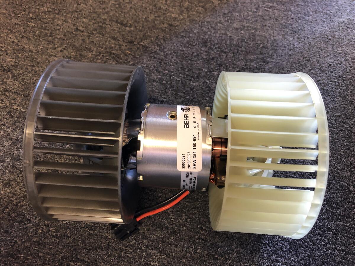

    Has anyone installed one of these lately? The design seems to have changed. It doesn’t fit into the factory bracket. When I looked at ECS, it appears the new OE includes a bracket I assume for this reason.
    Can anyone confirm?
    New unit

    Old unit

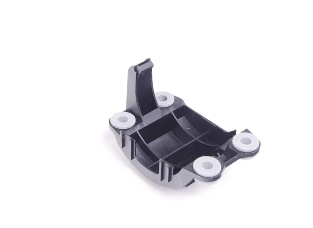

    Potential new bracket
    Yea, I can confirm. I tried to install the new blower into the existing bracket and realized its a different design. I luckily had the new bracket shipped with my blower, but not sure how to get one if it did not
      Which one did you buy that came with the bracket? BMW brand?
        I got it from Tischer BMW so it was genuine part
          I bought this one and the holder is included. Costs about 100 €
            Do you have any pics of the install? I got the new blower today (which included the bracket) but the orientation seems off. The power plug is either in the back or the very front and isn’t long enough.
              Sorry man no pics. I wish i did. Maybe if you can post pics which shows the issue i can jog my memory. Or maybe someone else can comment
